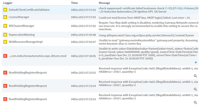

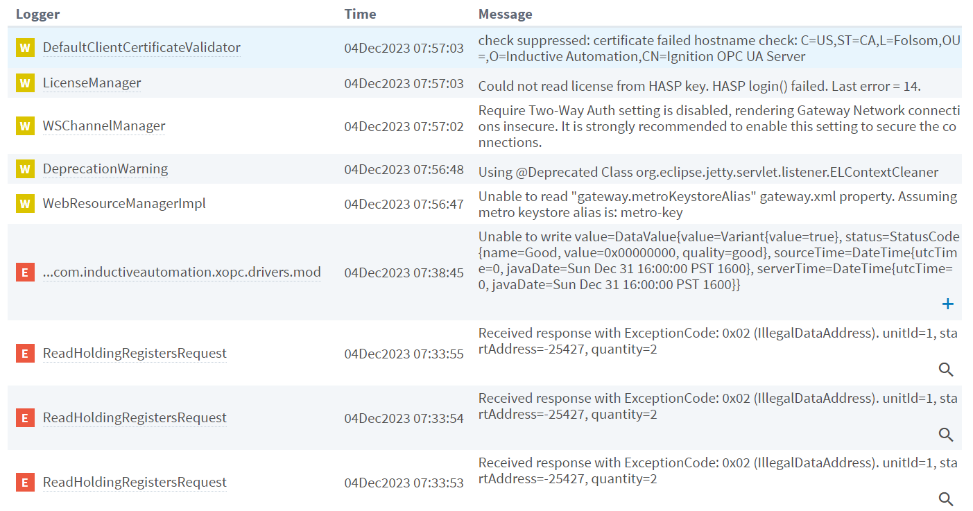

**Author:** ![Barbara\_Frumas](https://avatars.discourse-cdn.com/v4/letter/b/94ad74/32.png) [@Barbara\_Frumas](https://forum.inductiveautomation.com/u/Barbara_Frumas)\
**Post date:** [December 4, 2023, 5:02pm UTC](https://forum.inductiveautomation.com/t/modbus-address-with-letter/82665/9 "2023-12-04T17:02:25Z")
Here is my log for warnings
 ![warn](https://us1.discourse-cdn.com/inductiveautomation/original/3X/7/b/7b118dbca3719ff8833c2014f0a7648b94093a93.png)
**Post date:** [December 4, 2023, 5:03pm UTC](https://forum.inductiveautomation.com/t/modbus-address-with-letter/82665/10 "2023-12-04T17:03:51Z")
Well, that's the device telling you the address you're requesting is no good.
Go back to the advice we both gave you earlier.
No address map. Manually addressed tags. Read the manual for the syntax. Address `HR110`, not `HR40110`.

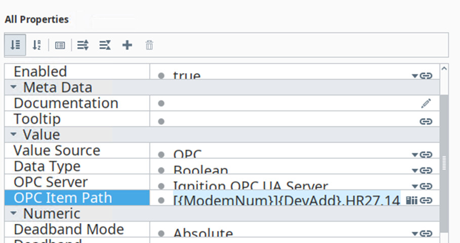

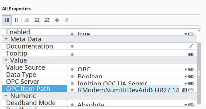

**Author:** ![dnsfontenot](https://avatars.discourse-cdn.com/v4/letter/d/b5ac83/32.png) [@dnsfontenot](https://forum.inductiveautomation.com/u/dnsfontenot)\
**Post date:** [December 4, 2023, 6:52pm UTC](https://forum.inductiveautomation.com/t/modbus-address-with-letter/82665/12 "2023-12-04T18:52:44Z")
Might try this configuration below. You need to add the device address.. This would get holding register 40028 bit 5 or 6 depending on your device being 0-15 or 1-16 bit based.
[{ModemNum}]{DevAdd}.HR28.6
**Post date:** [December 4, 2023, 7:33pm UTC](https://forum.inductiveautomation.com/t/modbus-address-with-letter/82665/13 "2023-12-04T19:33:22Z")
what would ModemNum and DevAdd be? vs the above [devicename]
**Post date:** [December 4, 2023, 8:11pm UTC](https://forum.inductiveautomation.com/t/modbus-address-with-letter/82665/14 "2023-12-04T20:11:07Z")
> [@pturmel](#):
> [someDevice]HR110.15
I couldn’t get the modbus address configuration to work under the OPC UA, Device Connections section. So I mapped the device in the OPC Item Path… Mine are using parameters but yours would look like. [someDevice]1.HR110.15
Notice I had to add the 1 for the modbus device address if it's the first device.
This allows the Device, then modbus device address, then the holding register then the bit to read.
 ![image](https://us1.discourse-cdn.com/inductiveautomation/original/3X/b/d/bd2913d3217dd2625a4ebd7684adaa154a861d32.jpeg)
