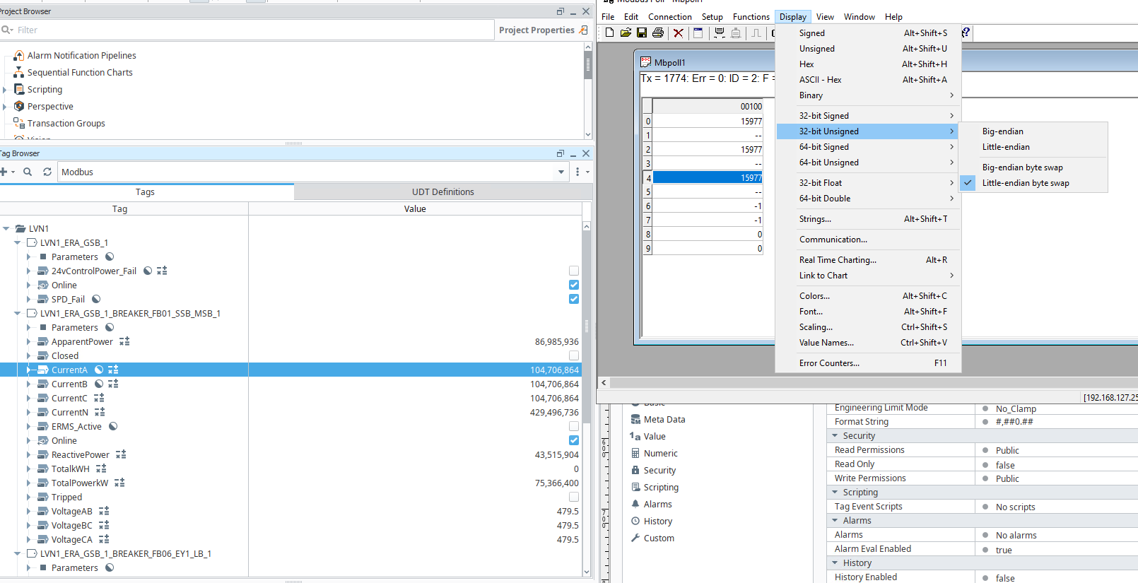

Hi, I am attempting to add a register that will only display properly with ModbusPoll as a 32-bit Integer with Little-endian byte swap. This is an ABB Ekip breaker Current. Is there any way to do a byte swap in Ignition? Any other suggestions? Here is a screenshot: [image]
 ![image](https://us1.discourse-cdn.com/inductiveautomation/original/3X/4/2/4268dc1a218839dda5665fbc715c5631ee1ddb6f.png)

**Post date:** [July 16, 2025, 7:42pm UTC](https://forum.inductiveautomation.com/t/modbus-byte-swap/108575/3 "2025-07-16T19:42:32Z")
Theres probably better ways, but you could create your own UDT and do the swapping with expressions within the UDT.
**Post date:** [July 16, 2025, 8:05pm UTC](https://forum.inductiveautomation.com/t/modbus-byte-swap/108575/4 "2025-07-16T20:05:01Z")
Have you already tried the "swap words" setting on Ignition's Modbus device?

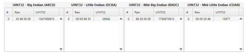

Here's the byte order so you know what you need to swap:
 ![image](https://us1.discourse-cdn.com/inductiveautomation/original/3X/8/8/8899adcc47a13bd1a1b3fac865a4d9b6ba99ab8b.png)

Where is the "swap words" setting?

In your example, I need to write an expression to derive that "Mid-Little Endian" CDAB. How did you get that?
**Post date:** [July 17, 2025, 3:46pm UTC](https://forum.inductiveautomation.com/t/modbus-byte-swap/108575/10 "2025-07-17T15:46:57Z")
It's an advanced setting on the Modbus device you set up in the Ignition Gateway.
