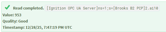

**Author:** ![ChrisAutomates](https://avatars.discourse-cdn.com/v4/letter/c/bc79bd/32.png) [@ChrisAutomates](https://forum.inductiveautomation.com/u/ChrisAutomates)\
**Post date:** [December 28, 2025, 7:58pm UTC](https://forum.inductiveautomation.com/t/modbus-only-working-in-quick-client/39148/5 "2025-12-28T19:58:06Z")
I have this same issue with ignition 8.1.47. I restarted the Modbus module and the OPC-UA module and nothing changed. My designer shows the tags as Bad\_Failure, but in quickclient if I read the tag it comes back w/ correct result almost instantly. Also if I subscribe to the tags in quickclient only the first tag works.

**Author:** ![michael.flagler](https://sea1.discourse-cdn.com/inductiveautomation/user_avatar/forum.inductiveautomation.com/michael.flagler/32/26272_2.png) [@michael.flagler](https://forum.inductiveautomation.com/u/michael.flagler)\
**Post date:** [December 28, 2025, 8:17pm UTC](https://forum.inductiveautomation.com/t/modbus-only-working-in-quick-client/39148/6 "2025-12-28T20:17:37Z")
Even though the capability exists to create modbus tag mappings, it's recommended to not use it and to directly link to the registers following the proper naming convention.

**Post date:** [December 28, 2025, 8:19pm UTC](https://forum.inductiveautomation.com/t/modbus-only-working-in-quick-client/39148/7 "2025-12-28T20:19:54Z")
Follow Kevin's advice above:
- Delete your address mappings (as Michael notes, they are not recommended, especially when troubleshooting).
- Create **one** manually addressed OPC tag at the default pace. Ensure the manual address includes the unit address if non-zero.
- If that works, add more tags until you hit a problem.
