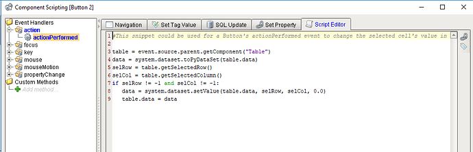

I am trying to create script to modify 1 cell in selected row (Status).
I have copied code from Ignition site, but it give me error.
 ![](https://us1.discourse-cdn.com/inductiveautomation/original/2X/2/2950b400dc3c36220aa93f7c45d9ae4de2d08cb4.png)
It changed “scanned” value to “0.0” but then, error is displayed and old value comes back. The value is fixed and will be always the same. 0.0

**Post date:** [August 15, 2018, 3:50pm UTC](https://forum.inductiveautomation.com/t/modify-selected-cell-value/19268/2 "2018-08-15T15:50:11Z")
Your script is actually fine - the ‘Error running update query’ is a bug on our side in Ignition 7.9.7/7.9.8. Ignition 7.9.9, out within a couple weeks, will fix this issue.

**Post date:** [August 17, 2018, 10:48am UTC](https://forum.inductiveautomation.com/t/modify-selected-cell-value/19268/7 "2018-08-17T10:48:07Z")
Your problem is that you have two different items writing to the same property: your binding, and your script. You will never get the scripted value to stay there as long as the binding is delivering data. You need two separate properties. A custom property bound to original data, and your script watching for it to update and writing the adjusted dataset to the data property.
