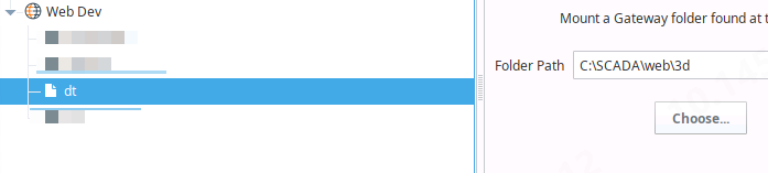

hello,
I want to mount a new web page via Ignition Web Dev Module, because I see a page describing the function of mounting a folder containing index.html. and it can be access from browser
 ![image](https://us1.discourse-cdn.com/inductiveautomation/original/3X/5/7/57adad246118ff6f2b29dc3421c0c5846a8c7011.png)
I created a web page folder and tried to create a new web dev mounted folder like this
 ![WXWorkCapture_17546620256509](https://us1.discourse-cdn.com/inductiveautomation/original/3X/b/f/bf10ebae062e6b3d2d5bbdf4729f58d1fabe5f54.png)
go to the link
 ![image](https://us1.discourse-cdn.com/inductiveautomation/original/3X/4/3/43b7fb63c12dd7876a42a14cb5b1ce130e0cb1b8.png)
## returned 404 not found.
can you tell me how i can mount a frontend page in ignition.. Thank you 👍
**Post date:** [August 8, 2025, 3:41pm UTC](https://forum.inductiveautomation.com/t/mount-a-new-html-folder-by-ignition-web-dev-module/109534/2 "2025-08-08T15:41:28Z")
Does the `C:\SCADA\web\3d` exist **on the gateway** , and does whatever account is running the Ignition gateway (by default, the `LOCAL_SYSTEM` service user) have access to that folder?
What do the contents of the folder look like?
The path you would use in the web browser would be `/system/webdev/FR_SCADA/dt/some/remaining/path` to whatever files in the folder, also. There's no automatic serving of an `index.html` or similar if you use a bare path.

Hello,
The folder existed on the path . I only found LOCAL\_SYSTEM users on my computer and I granted full access to the SCADA folder
 ![image](https://us1.discourse-cdn.com/inductiveautomation/original/3X/8/2/82b9b20022404ef87e1891b7a456387479699539.png)
I will check it. Thank you for your reply
