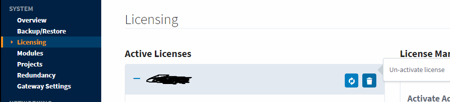

We are migrating our Ignition Edge from one computer to another, I have duplicated the environment.
Is there a way to move the license from one computer to another one. We are removing Ignition on the first computer and moving it to the other one. Can’t find a button for that.
Ideas?
**Author:** ![witman](https://avatars.discourse-cdn.com/v4/letter/w/d2c977/32.png) [@witman](https://forum.inductiveautomation.com/u/witman)\
**Post date:** [September 23, 2019, 3:45pm UTC](https://forum.inductiveautomation.com/t/moving-an-ignition-license/28471/2 "2019-09-23T15:45:50Z")
Un-activate the license on the old computer (garbage icon):
 ![image](https://us1.discourse-cdn.com/inductiveautomation/original/2X/0/0dbbc52d19b7d601fa65ff8e24ce0f5815260e24.png)
And then activate it on the new computer.
