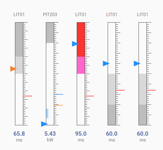

Seems strange to me that the MovingAnalogIndicator component in Perspective has ability to have 4 alarm zones:
LoLoAlarm
LoAlarm
HiAlarm
HiHiAlarm
But we can only set **TWO** alarm colors..??
 ![image](https://us1.discourse-cdn.com/inductiveautomation/original/3X/3/2/322707229cff307959cc09c92d88891cd86485e2.png)
It kinda hamstrings us if we wanted to have the HiHiAlarm a different color to the LoLoAlarm.
Which is totally valid depending on what priorities we'd set alarms at.
Is this something that could get modified for future releases?

Hmm, I guess that makes sense setting the range colour to the priority colour - I never thought about that.
(shameless plug) I have finally added my analogue indicator to the exchange, awaiting review. While I use the same philosophy (H/L and HH/LL use same colour), you could easily modify my component to use 4 colours. It also overcomes some of the issues with the MAI.
I embedded this component into an Analogue Instrument View template to use with an AI UDT which has the PV, alarm ranges, etc. so that would make it easy to template the alarms and their priority colours into it. For mine I just used an ASM alarm symbol that has the priority colour/number/shape
 ![ASM Analogue Indicator v1.1 - img1](https://us1.discourse-cdn.com/inductiveautomation/original/3X/1/5/1510e85ae9afac26da5a1570b4da68eab31eea40.png)

I would think you could set those colors dynamically via binding.
**Author:** ![richardNZ15](https://sea1.discourse-cdn.com/inductiveautomation/user_avatar/forum.inductiveautomation.com/richardnz15/32/33373_2.png) [@richardNZ15](https://forum.inductiveautomation.com/u/richardNZ15)\
**Post date:** [July 17, 2024, 1:10am UTC](https://forum.inductiveautomation.com/t/movinganalogindicator-need-more-alarm-levels/93268/4 "2024-07-17T01:10:19Z")
You could but that just seems unnecessarily complicated. You'd need to look at the PV to figure out if the color needs to represent the HighHigh or the LowLow value.
Just seems like its a half implemented component.

**Post date:** [July 17, 2024, 1:51am UTC](https://forum.inductiveautomation.com/t/movinganalogindicator-need-more-alarm-levels/93268/6 "2024-07-17T01:51:09Z")
Exactly... using two independent components is also fraught with issues when the page size chagnes too when trying to keep them aligned (it doesn't work) - note that in my component the bar and scale are part of the same SVG so there's no chance these will ever become misaligned.
Also, this is the issue I see with using alarm priority colours:
 ![image](https://us1.discourse-cdn.com/inductiveautomation/original/3X/0/f/0f25889c54bf83a671da1a10f23e3501a801821a.png)
HH = Critical, H = Medium
The colours blend together, not enough contrast, maybe?

Perhaps... Alarm priority colors can always be customized to suit though. Although the Ignition defaults are reasonably good.
Maybe changing BG color of the PV indicator would be good enough.
How did you say you utilized the ASM alarm symbol? On the device popup or on the device shown on the "mimic / screen" ?
**Post date:** [July 17, 2024, 1:57am UTC](https://forum.inductiveautomation.com/t/movinganalogindicator-need-more-alarm-levels/93268/8 "2024-07-17T01:57:05Z")
> [@richardNZ15](#):
I did try this after a suggestion from a colleague, but it's not obvious enough (far left example):
 ![image](https://us1.discourse-cdn.com/inductiveautomation/original/3X/d/d/dd110f7f481e97395bc283bf73f6ee1954107ecc.png)
> [@richardNZ15](#):
I'm using the colours from HPHMI standards, so I can't really change them.
> [@richardNZ15](#):
I embedded my analogue indicator into another template view and added the alarm symbol into that
