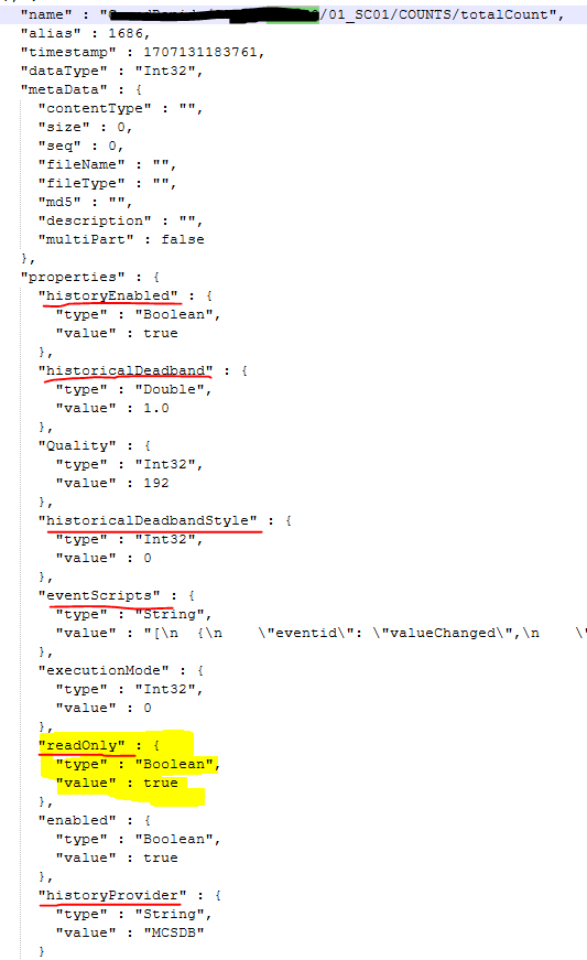

Hi,
I was under the impression that the non-filtered tag properties sent over MQTT Transmission would populate automatically in the MQTT Engine tags on BIRTH. So far, I tried many different scenarios with no luck to get this working.
**Versions:**
Ignition Edge 8.1.33 - MQTT Transmission 4.0.20
Ignition Standard 8.1.32 - MQTT Engine 4.0.20
Default Sparkplug B namespace and other default settings
**Edge Transmitter Config:**
Convert UDTs - **Enabled**
Device level UDTs as Devices - **Enabled**
Under **Advanced Settings/Filtered Properties:**
I have removed all the historical-related properties as well as the event scripts leaving only:
`accessRights;clampMode;deadband;deadbandMode;formatString;opcItemPath;opcServer;permissionModel;rawHigh;rawLow;scaleFactor;scaleMode;scaledHigh;scaledLow;tagGroup;valueSource;expression;expressionType;ConfiguredTagPath;readPermissions;writePermissions;parentEnabled;sourceTagPath`
**MQTT Engine → Advance Settings/ Filtered Properties:**
Also removed the same properties so the MQTT engine autocreates the tags accordingly:
When I subscribe to the DBIRTH topic I can see the properties are sent to the broker as expected:
 ![image](https://us1.discourse-cdn.com/inductiveautomation/original/3X/e/0/e09ed066037670f73dc3b5c6c88b295c21646297.png)

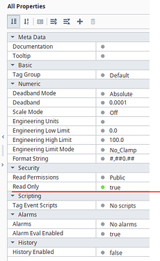

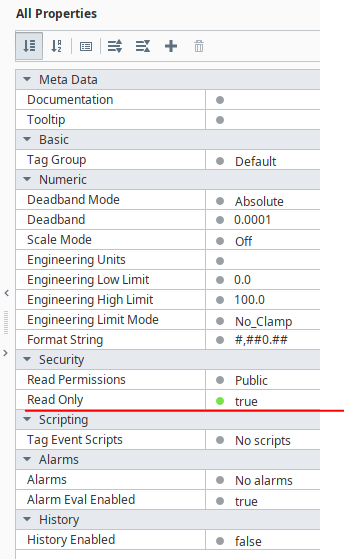

On the Ignition tag browser only the **Read Only** property is properly updated on every tag under the corresponding Node/device of the MQTT Engine provider
 ![image](https://us1.discourse-cdn.com/inductiveautomation/original/3X/f/9/f94fdea698449dae0bba7b6f51f491f937628d63.png)
What is the expected behaviour then?
