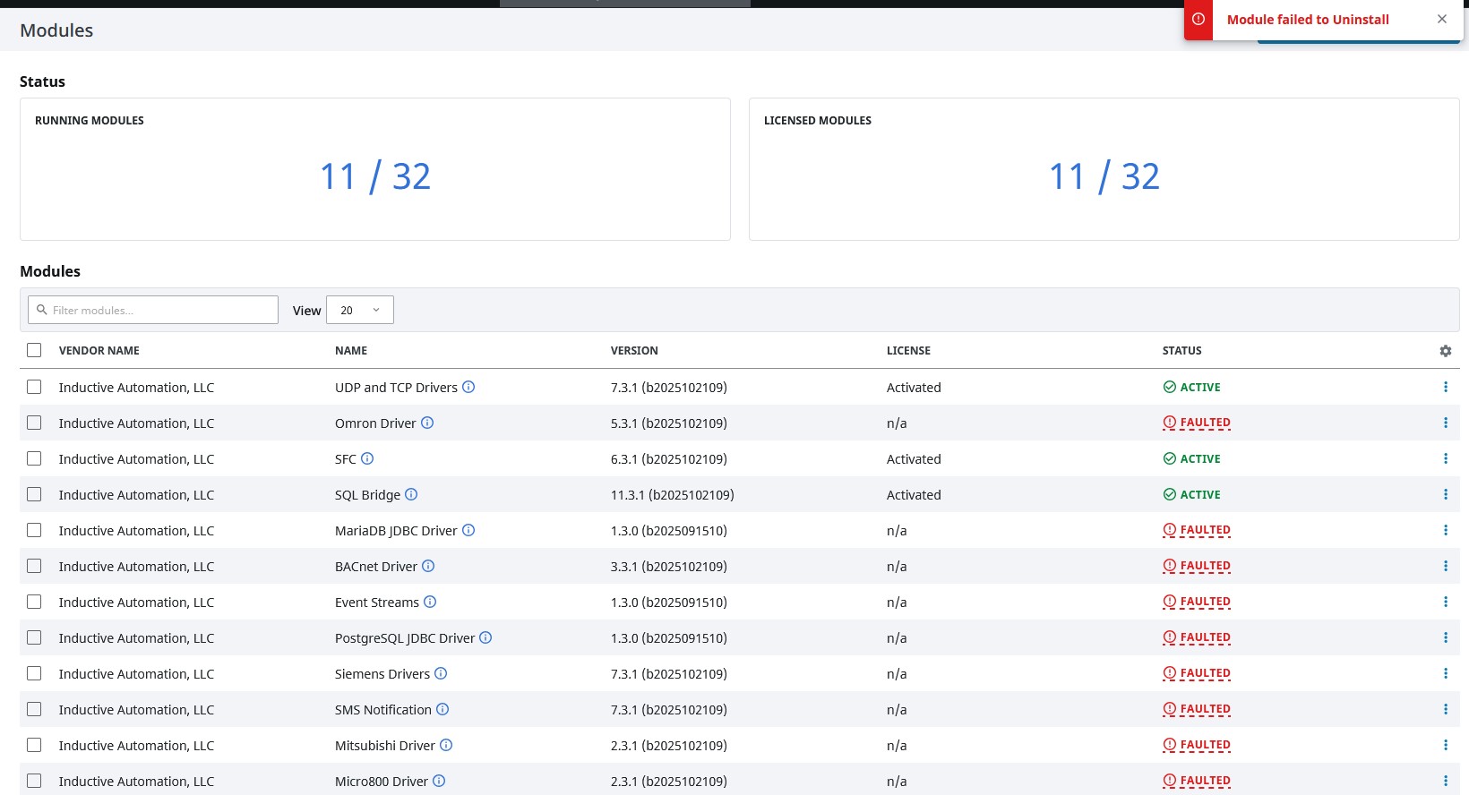

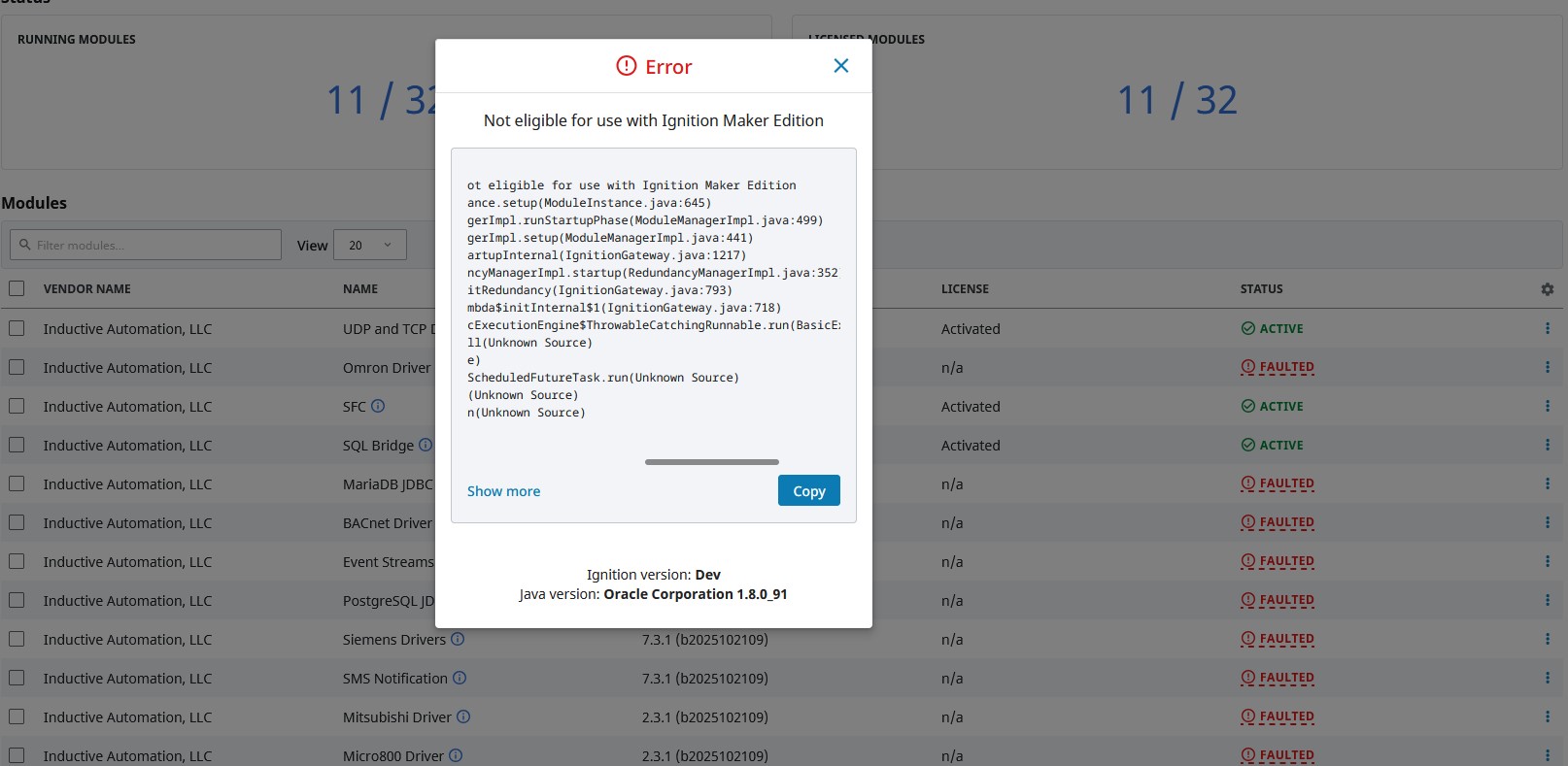

One last question, i see a lot of modules that are not support but it wont let me remove them, is that a bug or am I doing something else wrong?
 ![error 1](https://us1.discourse-cdn.com/inductiveautomation/original/3X/b/4/b47e6e7bd3bec76296131b604c25535e56875aad.jpeg)
 ![error 2](https://us1.discourse-cdn.com/inductiveautomation/original/3X/0/a/0a396c32e10d816f94f235eb02cb9553fdafe194.jpeg)
**Post date:** [December 2, 2025, 3:20pm UTC](https://forum.inductiveautomation.com/t/mssql-removed-from-maker/112536/8 "2025-12-02T15:20:27Z")
I think because you are using Docker you have to either disable them via configuration (`GATEWAY_MODULES_ENABLED` env var) or create a derived image without them.
> **[Platform Environment Variables | Ignition User Manual](https://docs.inductiveautomation.com/docs/8.3/appendix/reference-pages/platform-environment-variables#environment-variables)**
> The environment variables listed on this page are supported by the Ignition platform and work on a wide variety of operating systems including Docker, Linux, Windows, and macOS. You can add environment variables to automate certain processes, access...
**Author:** ![drewdin](https://sea1.discourse-cdn.com/inductiveautomation/user_avatar/forum.inductiveautomation.com/drewdin/32/3363_2.png) [@drewdin](https://forum.inductiveautomation.com/u/drewdin)\
**Post date:** [December 2, 2025, 3:37pm UTC](https://forum.inductiveautomation.com/t/mssql-removed-from-maker/112536/9 "2025-12-02T15:37:28Z")
Thanks, I was already using that and the ones I have enabled show up as active and the rest show up as FAULTED. I also updated the modules names I.E.
GATEWAY\_MODULES\_ENABLED=alarm-notification
is now
GATEWAY\_MODULES\_ENABLED=com.inductiveautomation.alarm-notification
I’ll keep poking around.
