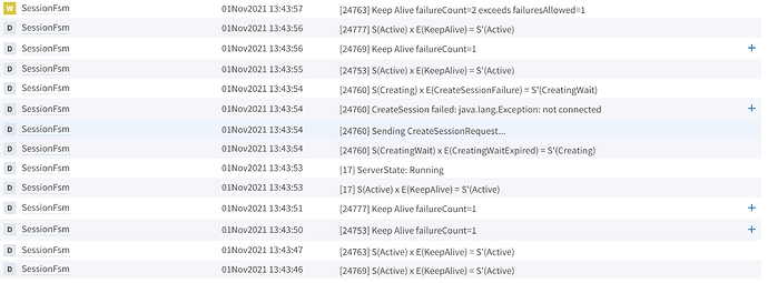

I am having a persistent issue where my OPC connections all drop at the same time. Currently we have 8 connections, 4 of which will drop simultaneously and have to be manually reconnected (3 are intentionally deactivated and 1 is Ignitions default connection).
I had some issues relating to CPU/RAM capacity that I thought was causing the problem as the CPU usage would easily hit 90%+ usage, but after upgrading the cloud instance the problem persists (though less frequently).
I have logging for some of the OPC related Logger’s turned to DEBUG and capture events like this:
 ![Screen Shot 2021-11-01 at 2.46.58 PM](https://us1.discourse-cdn.com/inductiveautomation/original/3X/7/a/7a2f0fbcbec951304ad4c517c949dcd9c7c8fd1e.png)

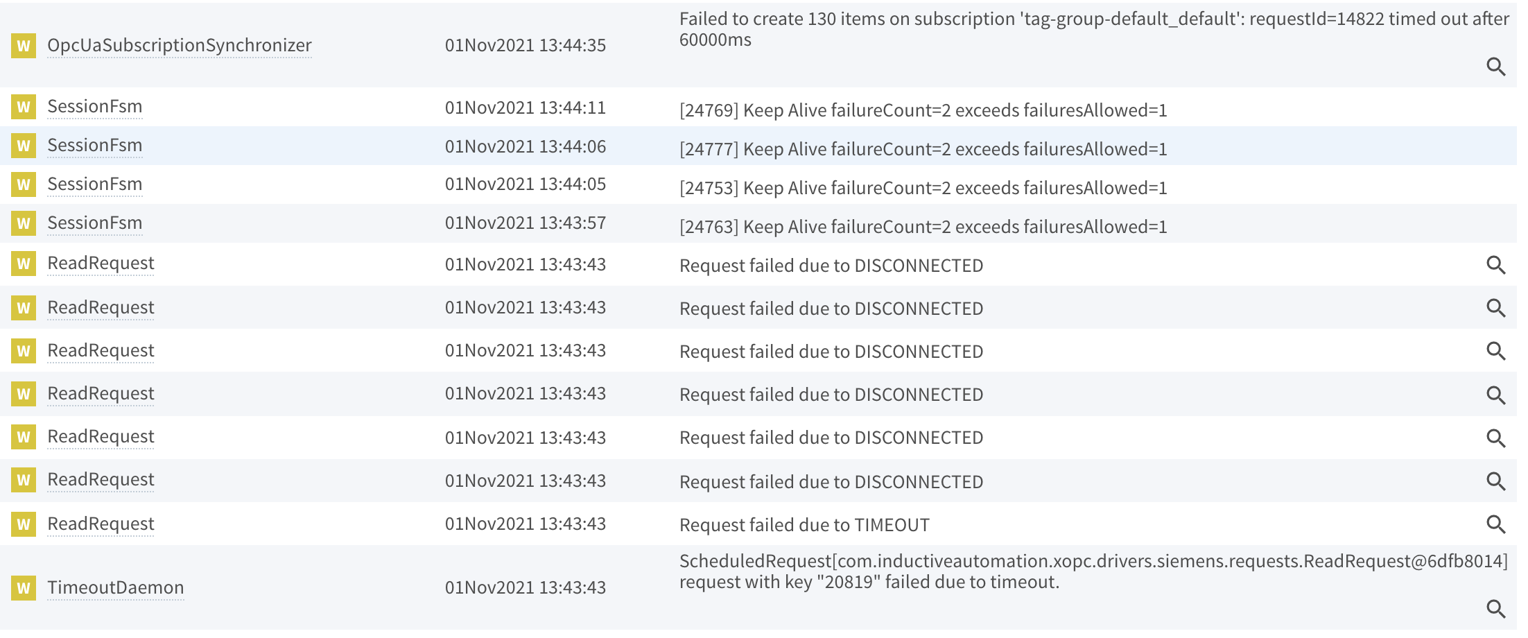

I do have the SessionFsm DEBUG info as well:
 ![Screen Shot 2021-11-01 at 2.50.04 PM](https://us1.discourse-cdn.com/inductiveautomation/original/3X/c/0/c02eda9b09ba4fb7c77b6ca5d2e131dde1bd623b.png)
Which Logger/Loggers should I change the level of to better capture that event that is causing this? Any help in diagnosing the issue would be. It is occurring with both a Siemens device and multiple Beckhoff devices.
**Post date:** [November 1, 2021, 9:57pm UTC](https://forum.inductiveautomation.com/t/multiple-opc-connections-faulting-at-the-same-time/52592/2 "2021-11-01T21:57:52Z")
The SessionFsm logger is already a good start. It’s pretty clear that the disconnect is because the keep alive requests stop getting responded to.
