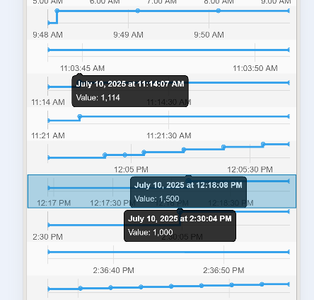

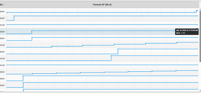

**Post date:** [July 10, 2025, 7:01am UTC](https://forum.inductiveautomation.com/t/musson-industrial-s-embr-charts-module/91618/273 "2025-07-10T07:01:28Z")
Hey @bmusson , how would I enable `props.scales.x.ticks.display` on hover of the chart via JS (and remove after)?
The reason is, I have a table of these charts and I don't want it cluttering the view unless the user is actively looking at a chart (maybe... I want to see how it looks)
 ![image](https://us1.discourse-cdn.com/inductiveautomation/original/3X/9/6/96269abaf83f2744cb76cdaed3b2e4d4823f45f7.png)
 ![image](https://us1.discourse-cdn.com/inductiveautomation/original/3X/1/f/1f2bd446359deb304ca0a543195e5d1bf28f1151.png)
2nd Q:
How can I show the timestack times in 24hr time?
I've tried adding this and setting to `false` but it didn't change anything (from [here](https://github.com/jkmnt/chartjs-scale-timestack?tab=readme-ov-file#options))
 ![image](https://us1.discourse-cdn.com/inductiveautomation/original/3X/b/b/bb38c642e80ea144c33ff474ca1f230312bab9cd.png)
Sorry one more..
3rd Q:
How can I remove the tooltip on touch move end? I've found that if you touch and drag to move along the timeline to see different data point values in the tooltip, the tooltip stays there when you let go, and doesn't go away if for example you do the same thing on another chart. If you just touch and let go, then it removes the tooltips on the other charts and just shows it on the chart data point you touched.
The intended behaviour for me is:
- for touch drags, the tooltip only shows while you're touching the screen and disappears when you let go
- for instantaneous touches, the tooltip stays and only disappears upon another touch event
 ![image](https://us1.discourse-cdn.com/inductiveautomation/original/3X/7/0/702fed41efcd943f4e15bab1fb0277a344bbc5a2.png)

## 1. Enable Ticks on Hover
> [@nminchin](#):
Here's a plugin configuration that will do this, stick it in the `props.plugins` array:
```js
// plugins[index].beforeInit
(chart) => {
    chart.options.scales.x.ticks.display = false;
    chart.canvas.addEventListener('mouseenter', () => {
        chart.options.scales.x.ticks.display = true
        chart.update('none')
    chart.canvas.addEventListener('mouseleave', () => {
## 2. 24hr Timestack X-Axis
> [@nminchin](#):
> 2nd Q:
The documentation is wrong, the namespace is actually `options.scales[id].timestack`.
`options.scales.x.timestack.format_style.hour12 = false` should do what you want. It doesn't seem like changing this value will cause a render, it only evaluates when the chart first starts.
## 3. Remove Tooltip on Touch Move End
> [@nminchin](#):
Here's a plugin that should match the touch behavior you want:
```js
(chart) => {
    let dragStartX = 0
    let dragStartY = 0
    let wasDragging = false
    const DRAG_THRESHOLD = 8
    const canvas = chart.canvas
    const clearTooltip = () => {
      chart.tooltip.setActiveElements([], { x: 0, y: 0 })
    const onTouchStart = (e) => {
      if (e.touches.length === 1) {
        dragStartX = e.touches[0].clientX
        dragStartY = e.touches[0].clientY
        wasDragging = false
    const onTouchMove = (e) => {
        const dx = e.touches[0].clientX - dragStartX
        const dy = e.touches[0].clientY - dragStartY
        if (Math.hypot(dx, dy) > DRAG_THRESHOLD) {
          wasDragging = true
    const onTouchEnd = (e) => {
      if (wasDragging) {
        clearTooltip();
    canvas.addEventListener('touchstart', onTouchStart, { passive: true })
    canvas.addEventListener('touchmove', onTouchMove, { passive: true })
    canvas.addEventListener('touchend', onTouchEnd, { passive: true })
