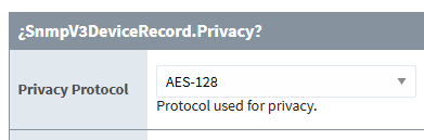

**Author:** ![andrew.budaiev](https://sea1.discourse-cdn.com/inductiveautomation/user_avatar/forum.inductiveautomation.com/andrew.budaiev/32/72921_2.png) [@andrew.budaiev](https://forum.inductiveautomation.com/u/andrew.budaiev)\
**Post date:** [October 7, 2025, 4:52am UTC](https://forum.inductiveautomation.com/t/musson-industrials-embr-snmp-module-beta/111185/44 "2025-10-07T04:52:18Z")
I tried two device connection with 0.2.0. Devices are connected and tags are good.
Just some minor things.
 ![image](https://us1.discourse-cdn.com/inductiveautomation/original/3X/a/d/adab40f88fd6f62707d63fa181a95ec7b2ae7ad0.png)
 ![image](https://us1.discourse-cdn.com/inductiveautomation/original/3X/c/0/c0054fab1a631389f5875a73bad2b4fbc4b50fa8.png)
**Author:** ![David\_Stone](https://sea1.discourse-cdn.com/inductiveautomation/user_avatar/forum.inductiveautomation.com/david_stone/32/79749_2.png) [@David\_Stone](https://forum.inductiveautomation.com/u/David_Stone)\
**Post date:** [October 7, 2025, 5:23am UTC](https://forum.inductiveautomation.com/t/musson-industrials-embr-snmp-module-beta/111185/45 "2025-10-07T05:23:13Z")
Normally they resolve after a gateway reboot, if they don't, its definitely a bug.
**Post date:** [October 7, 2025, 5:37am UTC](https://forum.inductiveautomation.com/t/musson-industrials-embr-snmp-module-beta/111185/46 "2025-10-07T05:37:28Z")
Reboot helped. Thanks.
