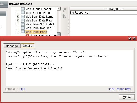

OOOOO quick question if you know, how does ignition deal with spaces in the tables inside of the database, when I click on the table it gives me an error and says that the name is an invalid object but only lists the first part of the db name until the first space.
 ![image](https://us1.discourse-cdn.com/inductiveautomation/original/3X/1/d/1d99a2586a00ad021d71f67eb4c278e2579f1c84.png)
**Author:** ![mforrest](https://avatars.discourse-cdn.com/v4/letter/m/8c91f0/32.png) [@mforrest](https://forum.inductiveautomation.com/u/mforrest)\
**Post date:** [August 10, 2022, 7:38pm UTC](https://forum.inductiveautomation.com/t/named-query-help-vision/62881/17 "2022-08-10T19:38:27Z")
Welp doesn’t appear to be the issue either, same error when I click a db with no spaces in the name
**Post date:** [August 10, 2022, 7:39pm UTC](https://forum.inductiveautomation.com/t/named-query-help-vision/62881/18 "2022-08-10T19:39:09Z")
Sorry, I don’t know. My earlier data source instruction was for Perspective. I forgot this is a 7.9 Vision project. Sorry.
