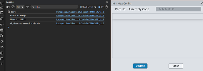

Hi,
So, I have a table in a popup which is supposed to receive the results of a named query, written on startup. I’m receiving an empty dataset but on testing the named query, it runs perfectly. Tried the query binding method, which also worked perfectly but on table’s onStartup, the below script is running but the dataset being returned is empty. Am I missing something?
 ![image](https://us1.discourse-cdn.com/inductiveautomation/original/3X/c/0/c04147d7741232139ce23cc05ccbd4f0114851f7.png)
 ![image](https://us1.discourse-cdn.com/inductiveautomation/original/3X/c/5/c570ad4819e5fe0ab444a7c4ccd534577cbbec61.png)
 ![image](https://us1.discourse-cdn.com/inductiveautomation/original/3X/1/7/17b1b961fa2fea21f72233ad952950f3c763aac2.png)

![image](https://us1.discourse-cdn.com/inductiveautomation/original/3X/6/f/6f4d8d3eb590f44fde99868e1bb5a32e3834e82c.png)
I believe if you turn this logger (it may be a different named query logger hopefully someone knows which) to debug, you will see the named query calls and it’s params logged to the gateway. I would start there to confirm that your parameters are exactly as you expect, there’s no hidden white spaces etc.
Edit: Wait I see this is on a runAction script? Show what extension function/setup you are using exatly here. Not to mention it seems like you are just doing a named query with a param - I don’t see why you shouldn’t do a named query binding on the data property. You can use `trim()` in an expression to do the same thing as `.strip()`

3. ![image](https://us1.discourse-cdn.com/inductiveautomation/original/3X/f/f/ff988ac644db7212740a183a8b932ac0571efd3a.png) This is onStartup for a table

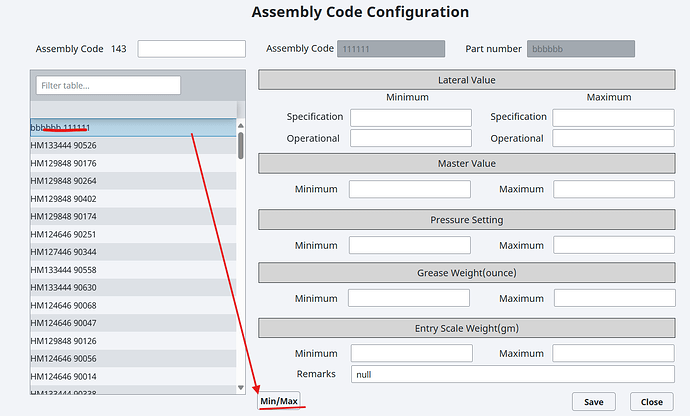

![image](https://us1.discourse-cdn.com/inductiveautomation/original/3X/9/6/96e4fc4752987f646b3bb7feac74ca7d0fbf704f.png)
which opens this popup -
 ![image](https://us1.discourse-cdn.com/inductiveautomation/original/3X/b/6/b64966f093d6249b4b0f6300bed91def20ac264e.png)
which is supposed to look like -
 ![image](https://us1.discourse-cdn.com/inductiveautomation/original/3X/a/d/ad3f4ca3408a671956aaa397540b9bee7e4de472.png)
where they need to edit each cell, update the db on click of the update button
**Author:** ![bkarabinchak.psi](https://sea1.discourse-cdn.com/inductiveautomation/user_avatar/forum.inductiveautomation.com/bkarabinchak.psi/32/83567_2.png) [@bkarabinchak.psi](https://forum.inductiveautomation.com/u/bkarabinchak.psi)\
**Post date:** [November 18, 2025, 2:28pm UTC](https://forum.inductiveautomation.com/t/named-query-returning-empty-dataset-on-table-startup/112248/11 "2025-11-18T14:28:51Z")
Since it looks like in the popup the part number/assembly code is disabled (since they picked it from the main view - that makes sense)
![image](https://us1.discourse-cdn.com/inductiveautomation/optimized/3X/a/2/a233f7d552b684df5e3aa20127ac7b6317f42d2b_2_690x43.png)
I 100% would just make the table a named query binding with a parameter bound to `trim({path.to.partNo})` and polling 0.

so i got it working with the binding, but i still haven’t figured out why the startup script didn’t return the right result?
**Post date:** [November 18, 2025, 2:46pm UTC](https://forum.inductiveautomation.com/t/named-query-returning-empty-dataset-on-table-startup/112248/13 "2025-11-18T14:46:52Z")
Probabbly because the onStartup, fired prior to the parameter resolving to its proper value.
