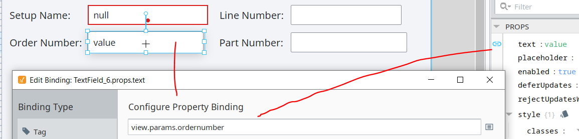

View 2:
 ![image](https://us1.discourse-cdn.com/inductiveautomation/original/3X/0/4/04201e665591b766f7d139ab6dbb44b4441ee5c1.png)
binded to text
 ![image](https://us1.discourse-cdn.com/inductiveautomation/original/3X/1/4/149147a7e4d534b0bcf87a2b36af7ef5a5c4b374.png)

First off, from the screenshot you posted of the View 2, your navigate code should be:
`system.perspective.navigate(view = 'Page/Embedded/Start_Complete_Line_Setup_test',params = {'ordernumber':orderNo})`
Don't confuse a URL with a view path, there are separate navigate method parameters for each.
If that still doesnt work, try manually setting:
`orderNo = 4444444`
in the onClick handler and see if the value is passed.
I just tested the setup here with a fixed value and it passed correctly.
If manually setting the value works, then make the link text bind to the order number to verify that you are getting the correct order number. I tested your setup here, and as long as the correct order number was in the `rowData.SAPOrderNumber` it was getting through to the window.
