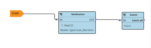

✅ **Current Setup:**
I've successfully implemented a pipeline in Ignition that sends an email notification to users whenever an alarm is triggered.
 ![image](https://us1.discourse-cdn.com/inductiveautomation/original/3X/d/c/dc3d83c5723c2455d467b982bf4912fbaf451f8b.png)
**Tag Details:**
- **Tag Name:** `XFMR [Modbus register HRUS2]`
- It’s a **16-bit register** , carrying multiple alarms within a single address.
**Alarm Configuration:**
- I created **16 expression tags** , each reading an individual bit from the register.
- An alarm is configured for each bit individually.
- When any bit changes from `0` to `1`, an associated alert is triggered, and the user receives an email.
**Next Goal** :
I'm now working on a **separate pipeline** that will send an email notification when the corresponding alert is **resolved** (i.e., the bit returns from `1` to `0`).
Current setup for Cleared alarm
 ![image](https://us1.discourse-cdn.com/inductiveautomation/original/3X/1/9/1993784424cfd03c5f5724869ced7e49f656759e.png)
 ![image](https://us1.discourse-cdn.com/inductiveautomation/original/3X/e/d/ed4e6d0065244f5354d1bb1fdffb02d30e079f9f.png)
I am getting an error in the gateway logs:
**"name=Alarm\_cleared\_pipeline,version=1753801615358] Alarm pipeline scheduled to retire."**
Can somebody help me make it successful?

In the alarm properties (part of the tag properties for each expression tag), did you set the "Clear Pipeline?"
If you do this, I suspect that `Switch` block isn't needed, but I've been wrong before.

Hi Zacht, yes i have mentioned the Active pipeline and clear pipeline
