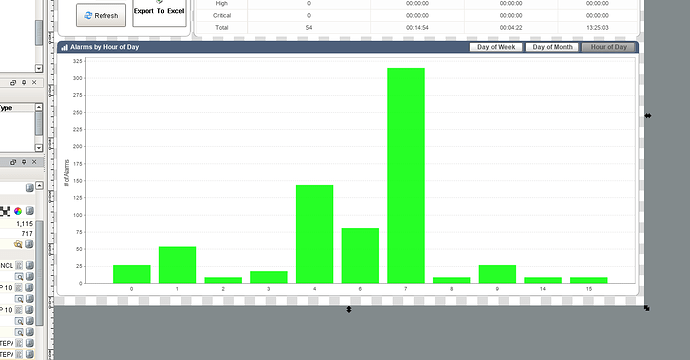

Below are photos of my bar graph and the query that the graphs gets it’s database from. Currently, the graph displays a bar for the COUNT sum of all\_spiral\_alarms (Spiral 1, Spiral 2, and Spiral 3). I’ve tried everything I know to do to get a bar displayed for each individual spiral alarms instead of a sum of all alarms, but it’s not quite good enough.
How do I get the COUNT of each spiral (Spiral 1, Spiral 2, Spiral 3) displayed in their own bars?
The bar chart.
 ![barChart](https://us1.discourse-cdn.com/inductiveautomation/original/3X/6/d/6d2d7d0deb581fda5d4bd7cd339e9fa4489ded50.png)
The query that the bar charts database gets it’s data from.
 ![barChartQuery](https://us1.discourse-cdn.com/inductiveautomation/original/3X/3/9/3996c6c8530288793a792983a372f832e94544fe.png)

So first things first, that is one impressive expression, any reason you didn’t use a named query? I think what you need to do is have a separate query(s) that you do your sum by spiral and then Union with your main queries. Im not ashamed to admit that i didn’t fully follow your expression, so no code will be forthcoming from me.
edit: Ooh, this is what you found at the exchange in your other topic.
**Post date:** [March 16, 2022, 11:31am UTC](https://forum.inductiveautomation.com/t/need-help-with-bar-chart-query/57243/5 "2022-03-16T11:31:57Z")
Cole, did you mention what db you’re using? I use the same analysis charts, but pared them down to just the postgres ones. My eyes started to cross after a looking at the orginals. 🤪
EDIT: Either way, you’ll need to add something to the GROUP BY portion of the query to separate out the individual spirals.

The {Alarms By Selection.Selection.groupBy} property (The Day of week / Day / Hour of Day multistate button) you can add what else to group by, tagging it on the end of the expression. If you put a display path on your alarms, to put a friendly name to them (and IMO, you should) it would look something like:

@lrose @pturmel
First off, I am so sorry!
After both of these edits, this is the error I get. I’ll embed the codes down below.
I’ll give context to as much as I can. There is an “all spirals” button that sets a property to “Spiral 0”. Also 3 more that set it to “Spiral 1”, “Spiral 2”, “Spiral 3”. When the property is “Spiral 0”, a new graph with it’s own query, multistate, and database becomes visible. When the property is not “Spiral 0”, the original bar graph with the original query, multistate, and database is visible.
I get this error for all 3 spirals when I add the multistate displaypath script to the new and original multistate.
 ![Irose_pturmeleditserror](https://us1.discourse-cdn.com/inductiveautomation/original/3X/b/c/bc20341cebf497af62664638eee41b62f42109b4.png)
This is the error I get if I only add the multistate displaypath script to the new multistate.
 ![image](https://us1.discourse-cdn.com/inductiveautomation/original/3X/e/1/e1803d32f2d05e0adc89a5b8be6f2228b63b04ee.png)
The new multistate script for “Spiral 0” graph as suggested by @lrose.

The final property using stringFormat as suggested by @pturmel.
```auto
stringFormat("%s, %s, %s", {Root Container.Alarm Analysis (1).spiral_id_data_extra_1}, {Root Container.Alarm Analysis (1).spiral_id_data_extra_2}, {Root Container.Alarm Analysis (1).spiral_id_data_extra_3})
This is the original query for the graph for one individual spiral at a time. I believe the error is referring to this query
````auto

**Author:** ![Cole\_Barthel](https://avatars.discourse-cdn.com/v4/letter/c/919ad9/32.png) [@Cole\_Barthel](https://forum.inductiveautomation.com/u/Cole_Barthel)\
**Post date:** [March 17, 2022, 10:03pm UTC](https://forum.inductiveautomation.com/t/need-help-with-bar-chart-query/57243/17 "2022-03-17T22:03:23Z")
This is the Spiral 0 query for the graph with all of the spirals.
