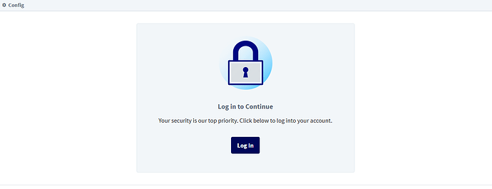

HI all, Wanna ask, i imported a secured project which login method using AD authentication from gateway. and now i am not able to login due to no connection to AD, is there a way to revert back to previous project which is not locked. I m still very new to this ignition.

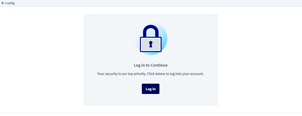

**Post date:** [August 5, 2025, 12:57am UTC](https://forum.inductiveautomation.com/t/need-some-help-on-project-import/109311/5 "2025-08-05T00:57:01Z")
attached the image for clearer question
 ![image](https://us1.discourse-cdn.com/inductiveautomation/original/3X/c/5/c5aa50fbb7c909db0057c6679c9ead14f5672c63.png)
once the login is pressed it will link to the ad which my machine is not even in the environment
 ![image](https://us1.discourse-cdn.com/inductiveautomation/original/3X/6/9/6922f4ea6da272833e0ef6412abba76dfc174267.png)
**Author:** ![jffgan](https://avatars.discourse-cdn.com/v4/letter/j/9f8e36/32.png) [@jffgan](https://forum.inductiveautomation.com/u/jffgan)\
**Post date:** [August 5, 2025, 1:33am UTC](https://forum.inductiveautomation.com/t/need-some-help-on-project-import/109311/6 "2025-08-05T01:33:03Z")
I somehow manage to found a solution to revert back to previous gateway configuration which running ok which the password secure link to local, by using the .\gwcmd -s (backup.gwbk) under the directory (C:\Program Files\Inductive Automation\Ignition) \<\< this path is default path where the ignition installed.
