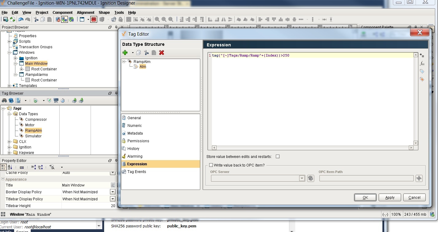

I created a data type in which I will have a parameter to indicate an alarm condition. I want to use it with an indirect reference, so that that the Index will be used in the tag path on each instance as follows:
tag{“Tags/Ramp/Ramp”+{Index))\>250
 ![](https://us1.discourse-cdn.com/inductiveautomation/original/2X/d/dddd1b56ee4197fd94bc8378109da55df5ca3f89.jpg)
This produces an error in the instance “Nested paths not allowed”
Error configuring tag for execution. Error:
Scan Error: Nested paths not allowed. (Line 1 , Char 25)
Is there another way to do this?
**Post date:** [December 7, 2018, 1:44pm UTC](https://forum.inductiveautomation.com/t/nested-paths-on-data-type-expressions/21279/3 "2018-12-07T13:44:24Z")
Replace your curly braces with regular parenthesis.
**Author:** ![pdixon](https://sea1.discourse-cdn.com/inductiveautomation/user_avatar/forum.inductiveautomation.com/pdixon/32/6899_2.png) [@pdixon](https://forum.inductiveautomation.com/u/pdixon)\
**Post date:** [December 7, 2018, 2:12pm UTC](https://forum.inductiveautomation.com/t/nested-paths-on-data-type-expressions/21279/4 "2018-12-07T14:12:22Z")
Thanks for your replies. I fixed the problem; the function tag() requires parens and the parameter Index requires curly braces.

{[edge]AIT\_001/H\_Alarm}
I am getting the error, nested path not allowed.
How I can use the indirect tag as **AIT\_001** in the expression?
**Post date:** [March 26, 2024, 11:27am UTC](https://forum.inductiveautomation.com/t/nested-paths-on-data-type-expressions/21279/6 "2024-03-26T11:27:44Z")
Create a custom property to retrieve the indirect tag. Use that property at that spot in your expression.
