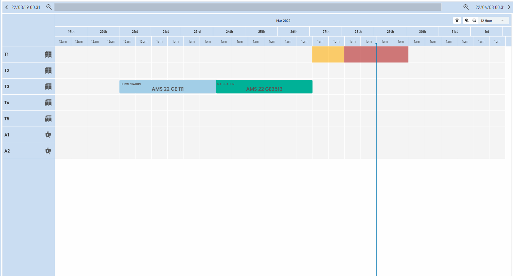

Hi @ayu
I have a problem showing the downtimes name(cause) in the scheduler.
As you know it is useless to show downtimes events without labels.
For example, it is nice to see downtime labels inside the area or show them as a tooltip when user hovers over it.
 ![image](https://us1.discourse-cdn.com/inductiveautomation/original/3X/2/0/204cb5128aa1ad10cb85c4807f0b468de3c43c32.png)
