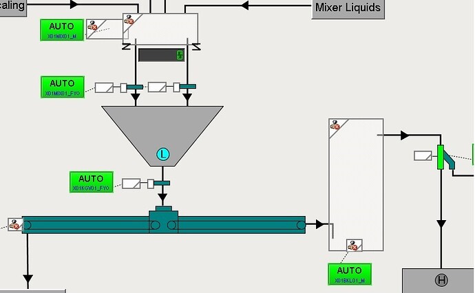

I’m currently having issues when I try to add a new template to my templates folder in the project browser. For some reason, when a new template is added, **some** of the templates on the client screen go white with a template error symbol. The designer and gateway screens; however, all appear to be working just fine. I’ve tried restarting the gateway and tried using a different computer with a different user, with no change. In order to fix the screens, I have to delete the template and open a brand new client screen. I’ve attached an image of a screen below. Please let me know if you need any additional information.

Resolved this issue by deleting the .ignition folder under Users.
