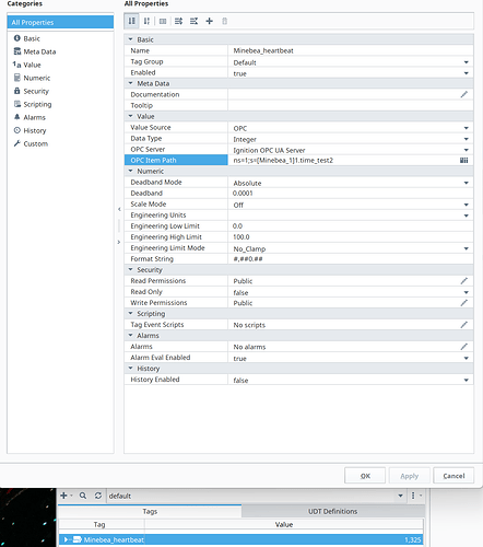

I can change the tag settings to the below, and I get the number shown, counting up.

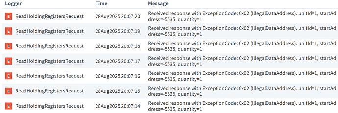

ps.. even with the tag working, and incrementing as shown, I still get this error in my logs.
 ![image](https://us1.discourse-cdn.com/inductiveautomation/original/3X/2/5/25493453d5abf4710310f33a83f27949368dbe14.png)
This device counts addresses from zero, and I have that configuration option selected in the device configuration as well.
**Post date:** [August 28, 2025, 8:46pm UTC](https://forum.inductiveautomation.com/t/new-user-connected-to-modbus-but-cant-get-tag-values-to-show/110254/3 "2025-08-28T20:46:22Z")
If your device starts at zero, then you need to set the Zero/One Based Addressing setting in the Ignition device settings appropriately.
I'd also recommend you skip the address mapping configuration and just create Ignition OPC tags with OPC Item Paths that use the Modbus address syntax described in the user manual, e.g. `[Minebea_1]1.HR0` (once you've configured the driver for 0-based addressing).

ok I was able to get it to work after taking your lead on it. I assume there is a way to read do this with a single tag Im just not doing it right? I only ask as there lots more data I have to get and I’ll have to write singular tags and expressions for all of them potentially.
**Post date:** [August 28, 2025, 10:16pm UTC](https://forum.inductiveautomation.com/t/new-user-connected-to-modbus-but-cant-get-tag-values-to-show/110254/5 "2025-08-28T22:16:41Z")
If there's a pattern to the addresses you may be able to use UDTs. Some people write scripts to create the tags. Others just create them all manually.
