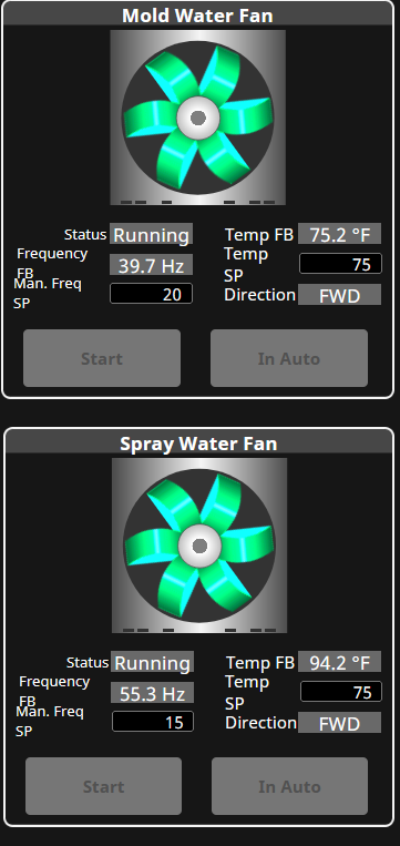

This is fantastic. I got it up and running on Ubuntu. However, I am running into the color of one of my animated fans is not correct. Since I cannot inspect the page I’m not sure how to troubleshoot. The following are animated fans on a currently working page. However, on the kiosk mode, they just show up as grey. Any ideas?
Probably worth noting the color comes from a “filter:sepia(40%) hue-rotate(100deg) saturate(10)” Prop.
\*\*\*\* After looking into it, the filter is being overwritten by the a url prop, but only in the kiosk hmi.
