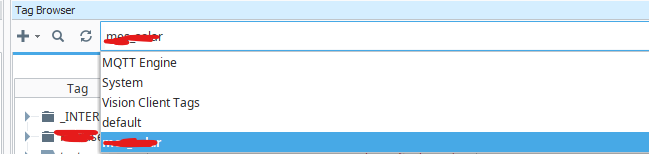

Hi,

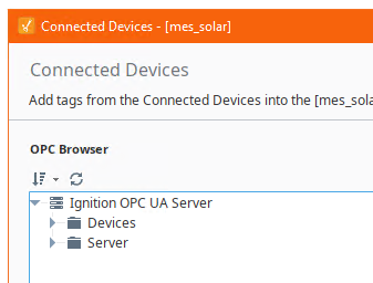

I am confused about adding tags to Tag Browser from MQTT, but when I am trying to do it, I can't see any Tag Providers in Browse Devices..
 ![image](https://us1.discourse-cdn.com/inductiveautomation/original/3X/e/c/ec3d5cef45069de4abbbd927e964b8de8744fdcb.png)
but in drop menu I have them:
 ![image](https://us1.discourse-cdn.com/inductiveautomation/original/3X/7/6/764b430360f70d68373a6214596103fb24a2233b.png)
What should it be? I have no qlue... first I thought it is in Security settings, but it didn't help me...

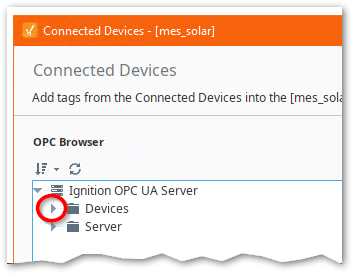

I never used MQTT.
 ![MQTT devices](https://us1.discourse-cdn.com/inductiveautomation/original/3X/e/7/e711302e5ece7eb55af0534cf13b69df5093eeca.png)
Did you expand the Devices node?

**Author:** ![iscrac](https://sea1.discourse-cdn.com/inductiveautomation/user_avatar/forum.inductiveautomation.com/iscrac/32/49757_2.png) [@iscrac](https://forum.inductiveautomation.com/u/iscrac)\
**Post date:** [January 13, 2025, 1:19pm UTC](https://forum.inductiveautomation.com/t/no-any-tag-provider-in-browsing-devices/100795/4 "2025-01-13T13:19:14Z")
Yes I did. No any Devices are in there...

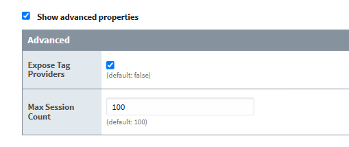

**Post date:** [January 13, 2025, 1:31pm UTC](https://forum.inductiveautomation.com/t/no-any-tag-provider-in-browsing-devices/100795/6 "2025-01-13T13:31:43Z")
You wouldn’t see them, or any other tag providers, unless the Exposed Tags setting for the OPC server is enabled.
But you shouldn’t be accessing tags this way from the same gateway that is exposing them.

Do you have the Engine module installed?
**Post date:** [January 13, 2025, 5:30pm UTC](https://forum.inductiveautomation.com/t/no-any-tag-provider-in-browsing-devices/100795/8 "2025-01-13T17:30:44Z")
![image](https://us1.discourse-cdn.com/inductiveautomation/original/3X/2/f/2fda77cbdacd569e5c0e9beab3dbd5093bb39e1e.png)
**Post date:** [January 13, 2025, 5:31pm UTC](https://forum.inductiveautomation.com/t/no-any-tag-provider-in-browsing-devices/100795/9 "2025-01-13T17:31:56Z")
yes. I know how to use MQTT Module, but I met this issue for the first time...
**Post date:** [January 13, 2025, 5:32pm UTC](https://forum.inductiveautomation.com/t/no-any-tag-provider-in-browsing-devices/100795/10 "2025-01-13T17:32:56Z")
Make sure to restart after enabling the "Expose Tag Providers" setting.
**Post date:** [January 13, 2025, 5:40pm UTC](https://forum.inductiveautomation.com/t/no-any-tag-provider-in-browsing-devices/100795/11 "2025-01-13T17:40:20Z")
Thank You! That worked!)
Something just went wrong with Ignition OPC UA Server after IT guys made some changes to network, so after the restart I changed the endpoint of this OPC Connection...
