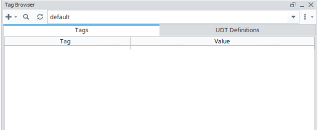

Hi, I’m new and working my way through the videos.
I Installed 8.1 gateway, and made connections to 2 ControlLogix processors successfully, connected to a SQL server, installed the designer, started a project. So far so good. In the videos, I notice in the tag browser, the default tag group includes several folders like Tags, System, All Providers. My tag browser has no folders in the default group. Did I set something up incorrectly?
![image](https://us1.discourse-cdn.com/inductiveautomation/original/3X/0/2/0247bfbe05d3f0ce0757f8f4f5f6442308258672.png)
**Post date:** [December 23, 2021, 12:26am UTC](https://forum.inductiveautomation.com/t/no-default-tag-folders/54418/2 "2021-12-23T00:26:29Z")
Ignition v7.9 and earlier always showed all the tag providers in the tree. v8+ shows only one, based on the dropdown selection. Many IU videos are v7.9.
Probably exacerbated by not setting a default tag provider for the project you are currently looking at.
