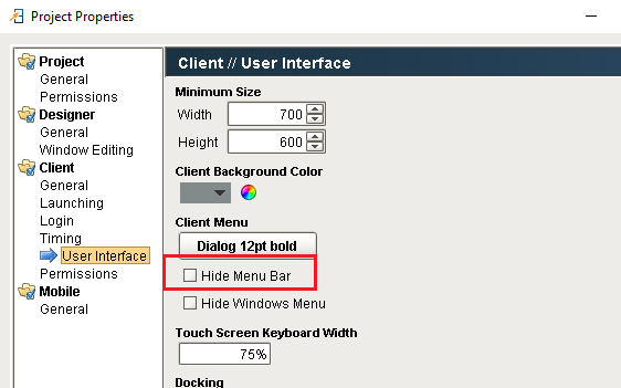

I’m not seeing the option to make a project full screen on a client. I’m trying to make it as such that it more closely resembles an HMI, than a PC they’re remote connecting into. How would I go about this?
**Post date:** [December 18, 2017, 5:07pm UTC](https://forum.inductiveautomation.com/t/no-drop-down-option-list-for-launching-a-project/16349/2 "2017-12-18T17:07:04Z")
In the designer, open that project and edit the project properties under “Client” =\> “Launching”.

So I set the settings to full screen, but it still launches with the taskbar up top.
**Author:** ![Paul.Scott](https://sea1.discourse-cdn.com/inductiveautomation/user_avatar/forum.inductiveautomation.com/paul.scott/32/4578_2.png) [@Paul.Scott](https://forum.inductiveautomation.com/u/Paul.Scott)\
**Post date:** [December 18, 2017, 6:08pm UTC](https://forum.inductiveautomation.com/t/no-drop-down-option-list-for-launching-a-project/16349/5 "2017-12-18T18:08:18Z")
You’ll also want to Hide the Menu Bar.

I got it, thank you ten fold!
