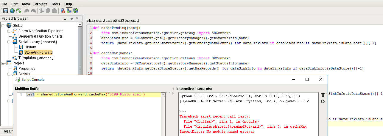

I’m trying to call a global shared function containing calls to the api from the script console.
I’ve included a screenshot to provide the context.
The function starts with:
‘from com.inductiveautomation.ignition.gateway import SRContext’
When calling the function in the script module, I get an error message that says ‘No module named gateway’
By the way, I get the same error if I try the put the function code directly in the script module.
In contrast, I created a tag which calls this function and the function calls executes properly there.
What am I missing?

You can’t run this in the script console because it’s executing in the Designer in that case.

I see.
So, how does one go about quickly/easily testing those kinds of functions?
**Post date:** [April 10, 2019, 6:58pm UTC](https://forum.inductiveautomation.com/t/no-module-named-gateway/24005/4 "2019-04-10T18:58:25Z")
A boolean memory tag and a tag change script seem okay to me.
**Author:** ![Kurt.Larson](https://sea1.discourse-cdn.com/inductiveautomation/user_avatar/forum.inductiveautomation.com/kurt.larson/32/6426_2.png) [@Kurt.Larson](https://forum.inductiveautomation.com/u/Kurt.Larson)\
**Post date:** [April 10, 2019, 7:06pm UTC](https://forum.inductiveautomation.com/t/no-module-named-gateway/24005/5 "2019-04-10T19:06:14Z")
You could also use sendRequest with a Gateway message handler that calls the shared scripts. Since you’re using a parameter, you could pass a payload within sendRequest to specify the datasink name.
In Gateway message handler: `shared.StoreAndForward.cachePending(payload["name"])`
In script console: `system.util.sendRequest("projectName", "messageHandlerName", {"name":"myDataSinkName"})`
