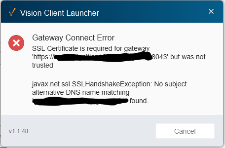

Hi everyone,
We are enabling SSL/TLS on our Gateway. We have a internal CA-provided cert and the entire chain has been added to the Gateway following IA's documentation. Our CSR and assigned cert includes the following:
Common Name: FQDN - something like ignition25.domain.global
SAN: ignition25
SAN: 192.168.1.125
When I use the Native Launcher and try to add a Gateway with FQDN, I get the following error when clicking "Trust" saying there's no subject alternative DNS name matching ignition25.domain.global
 ![image](https://us1.discourse-cdn.com/inductiveautomation/original/3X/5/4/54e1a6cf9d21fff88f31035d0548c67412e17287.png)
The .pem file gets added to .ignition\clientlauncher-data\certificates
Web browsing to [https://ignition25.domain.global:8043](https://ignition25.domain.global:8043) works fine
Web browsing to [https://ignition25:8043](https://ignition25:8043) works fine
I have tried various Launcher versions from 1.1.11 to 1.1.48 and all exhibit the same behavior.
If I add the Gateway in the Launcher with only the hostname [https://ignition25:8043](https://ignition25:8043) it works fine.
Why is the Native Launcher not using the Common Name for cert validation, and instead looking inside of the SAN? I can't find any documentation anywhere that says a SAN "must" include the Common Name/FQDN

This has been common practice internet-wide for years now. I'll see if I can find some docs for you, but you need to put all of the domain names under SAN entries. Using the CN has been a deprecated practice for a while.

Thanks @Kevin.Herron - I found some info online where it was recommended but didn't know it was required. I'll add it. Thanks for the quick response
**Post date:** [June 18, 2025, 4:24pm UTC](https://forum.inductiveautomation.com/t/no-subject-alternative-name-matching-found-for-ssl-cert-even-though-common-name-is-correct-in-native-launcher/107531/4 "2025-06-18T16:24:24Z")
[This](https://cabforum.org/working-groups/server/baseline-requirements/requirements/#7143-subscriber-certificate-common-name-attribute) states that if a CN is present, it must be an exact copy of one of the SAN entries, which implies your FQDN and other hostnames must be in the SAN entries, and the CN is optional.
