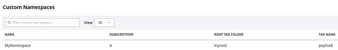

First time Ignition user.
Trying to get MQTT data (non sparkplug) into Designer 8.3.1 via Gateway with Custom Namespaces, Windows 11.
I have tried three separate MQTT brokers, Mosquitto local, Mosquitto on a remote machine and MQTT-Distributer locally. All three brokers can be r/w via two third party clients.
Via the Gateway logs (and verifying on the broker end) I can see the TCP connections connect and disconnect as expected.
I have followed the how to instructions but can see the Gateway is never actually polling any of the topics, have tried countless combos. I believe this why I have never seen anything populated in the tag browser in Designer?
I have disabled Elecsys and Sparkplug B. I can see the annoying “IamHost” being populated in Brokers. I have also reinstalled from scratch as I notice the Custom Namespace doesn’t always clear when deleted.
 ![Screenshot 2025-11-19 162026](https://us1.discourse-cdn.com/inductiveautomation/original/3X/f/e/fed40ec3ea5abd6d970f7ad4a94148c418774bcf.jpeg)
Any ideas?

The broker doesn’t matter as long as it conforms to the standard and the user ignition is logging in as has appropriate access permissions to read the topics you have subscribed to.
The IamHost is most likely the ignition server publishing its host state for sparkplug B devices to know it is online. You can disable the publishing of that message by saying that the ignition server is not a sparkplug b primary host.
The most important thing to point out is that there is no polling. MQTT is a pub/sub. Once you have your subscription setup, you should be able to publish whatever you like into the topics you have subscribed to and see the tags get generated in the engine tag provider. If the topic content is a json payload, you can even get engine to parse that and generate the tag structure to match.

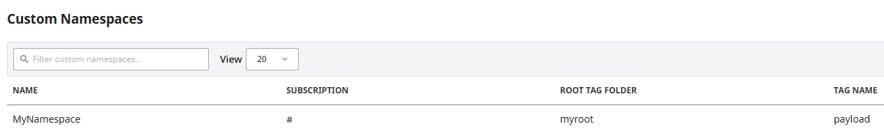

Also, just for you to try, I have “Create Writable Tags” enabled for my Custom Namespace:
 ![image](https://us1.discourse-cdn.com/inductiveautomation/original/3X/b/c/bce03c2d68b727f4ae9cab4af9fdeda9b6dc71b6.png)

No luck, passwords and ACLs setup.
I found this in the logger files:
![Screenshot 2025-11-22 131954](https://us1.discourse-cdn.com/inductiveautomation/optimized/3X/4/b/4bf0ea24e77af140aa70e290f3d3c4b3e67c2297_2_690x11.jpeg)
The only filter I can find in Gateway MQTT Engine is under the Server tab and it is blank.
If anyone else has an idea how to find why all topics are filtered, it would be appreciated.
Edited to add: I can subscribe to the broker with third party clients, I’m fairly confident the issue is in Ignition, I have two separate VMs configured and both are behaving the same way.
Every so often I can not delete a custom namespace, would that be a symptom of something else going on?
**Author:** ![truenorthsaf1](https://avatars.discourse-cdn.com/v4/letter/t/d07c76/32.png) [@truenorthsaf1](https://forum.inductiveautomation.com/u/truenorthsaf1)\
**Post date:** [November 23, 2025, 1:51am UTC](https://forum.inductiveautomation.com/t/non-sparkplug-mqtt-testing/112285/8 "2025-11-23T01:51:01Z")
8.15 works, it looks like an issue with 8.3.
Nice first impression, ugh.
