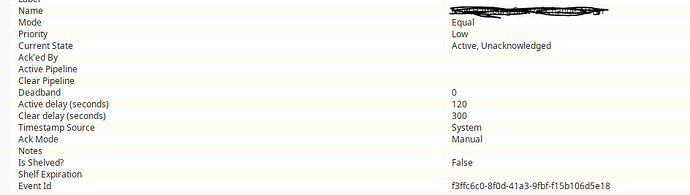

Just wondering if anyone else has run into issues with the alarming module on Ignition gateway 8.1.27 being unstable.
Example a defined alarm is triggered/shows up as an active alarm but no physical notifications are actually sent according to the audit logs on the gateway. This issue seems to be intermitted as well, no issues for month or two then all of a sudden without changes most alarms stop being notified but others go through.
I'm wondering if our tags/cache somehow got corrupted over time and needs to be regenerated/refreshed. Here are some screen shots below that support this theory
Screen shot showing the missing pipeline definition in Alarm Journal:
 ![image](https://us1.discourse-cdn.com/inductiveautomation/original/3X/b/0/b0a274767fdb008536297c3b2864c3cb1d39ff6a.png)

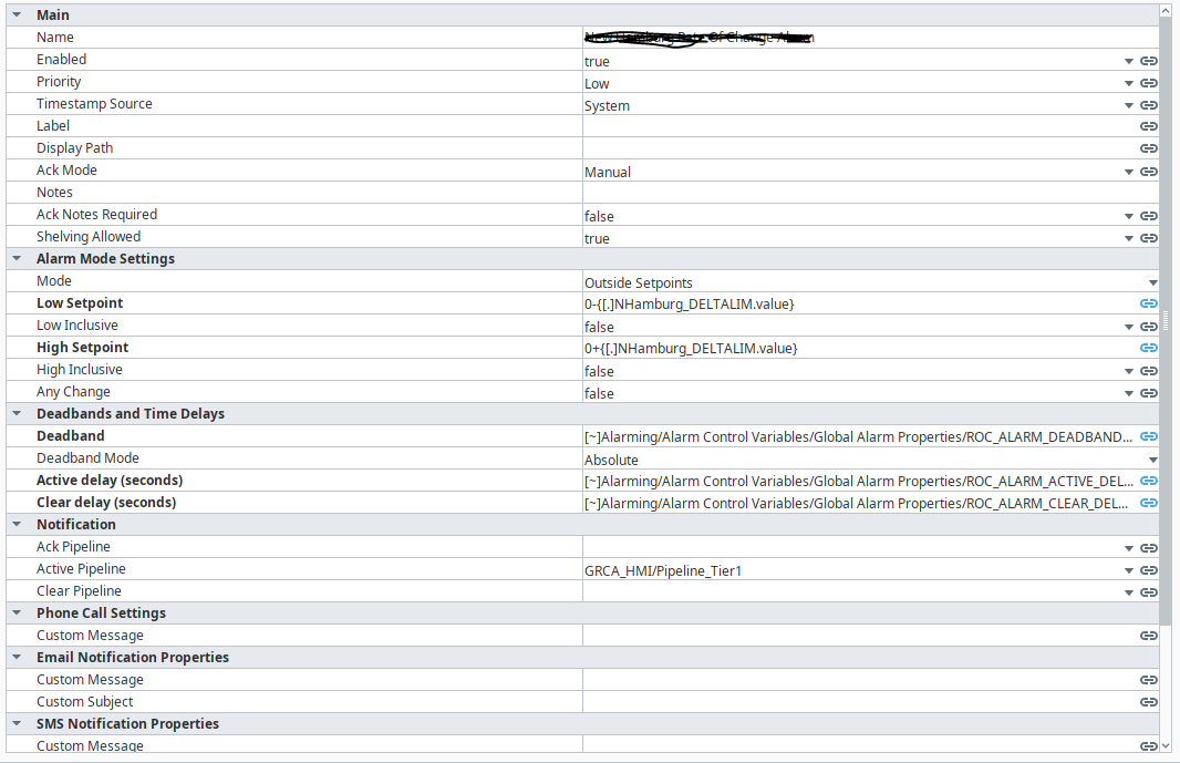

Screen shot showing the configured alarm:
 ![image](https://us1.discourse-cdn.com/inductiveautomation/original/3X/6/d/6da31e9da3eb0382b10d084e77708ed0d2a45fad.png)

Issue is resolved now, had to open every defined pipeline and without making any changes close and save them.
Somehow on the back end they got corrupted but no errors in the logs to indicate the cause.
