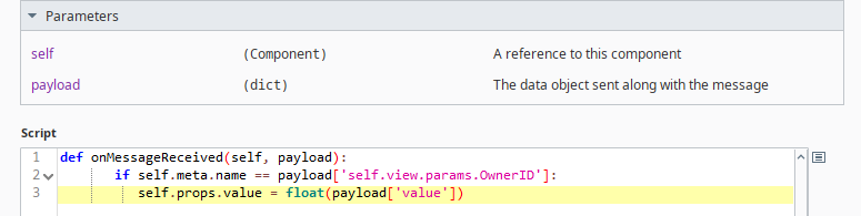

**Author:** ![pprickett](https://avatars.discourse-cdn.com/v4/letter/p/ecae2f/32.png) [@pprickett](https://forum.inductiveautomation.com/u/pprickett)\
**Post date:** [August 14, 2025, 12:12pm UTC](https://forum.inductiveautomation.com/t/num-keypad-in-perspective/76435/12 "2025-08-14T12:12:58Z")
Yes I have tried making it unique but now it wont write the setpoint.
Below is what I have changed on the numeric input and on the keypad popup.
Did I miss something?
 ![](https://us1.discourse-cdn.com/inductiveautomation/original/3X/b/b/bb5fcd5cd2c6cc36a048794f5401c2c3505d9eff.png)
 ![](https://us1.discourse-cdn.com/inductiveautomation/original/3X/9/d/9d57bf0fb8c8520a25b6827fb643e34c21e88d5f.png)
 ![](https://us1.discourse-cdn.com/inductiveautomation/original/3X/c/a/cac25147dee5b3f7304fad752ad2502ab0e1c704.png)

I’m guessing this keypad can not be used in a template because we can’t pass the owner ID.

**Author:** ![code\_skin](https://avatars.discourse-cdn.com/v4/letter/c/43a26b/32.png) [@code\_skin](https://forum.inductiveautomation.com/u/code_skin)\
**Post date:** [August 20, 2025, 12:15pm UTC](https://forum.inductiveautomation.com/t/num-keypad-in-perspective/76435/16 "2025-08-20T12:15:58Z")
> [@David\_Stone](#):
> `ownerId`
Did you try to match the casing here?
