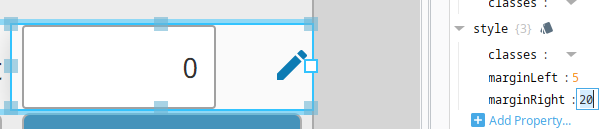

Hey,
I'm using a numeric entry field with button and trying to apply a margin on right side of it, but it seems the button desn't move, only the numeric field itself. I'm using version 8.1.30
Is this a bug, or should I put it in a different style?

The button has a separate styleclass which you can find using your browser's Development Tools - usually F12 and the select button on the top left.
In Project Browser | Perspective | Styles, right-click and enable Advanced Style Sheet. Add in the following:

You simply have to apply your margin on the containerStyle which is just above the style property

I noticed that `marginRight` exposes the background. `paddingRight` might look better for you.

I applied the style in the marginRight of this style and it seemed to append the margin to the outside of the object and caused some isses in my flex container.
However, using paddingRight in this container style worked perfectly.
Thanks!
