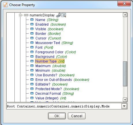

Noticed today that the user manual as well as the property binding system lists the scripting name for the number type of a Numeric Text Field as ‘Mode’. I have tried to use it in scripting and get an error. I am referencing this in scripting using the standard property insertion methods:
```auto
event.source.parent.getComponent('numericDisplay').Mode
I changed the line to:
```auto
event.source.parent.getComponent('numericDisplay').mode
and the script runs perfectly. I realize I am running 7.1.7 and am not sure if it has been fixed in the recent releases, but just figured you guys would want to know…

You’re absolutely right. Thanks for pointing this out, it’ll be fixed for the next release.
