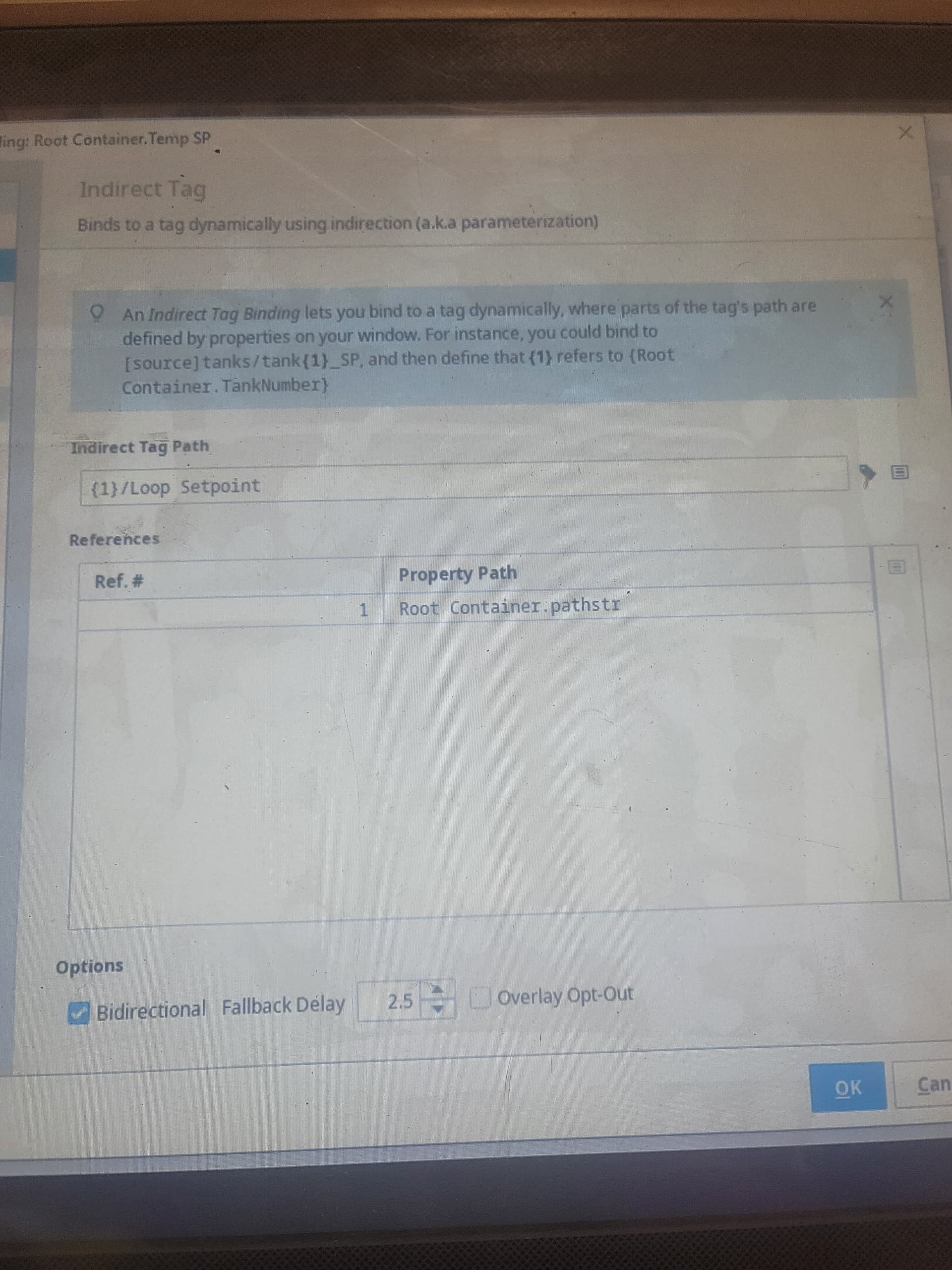

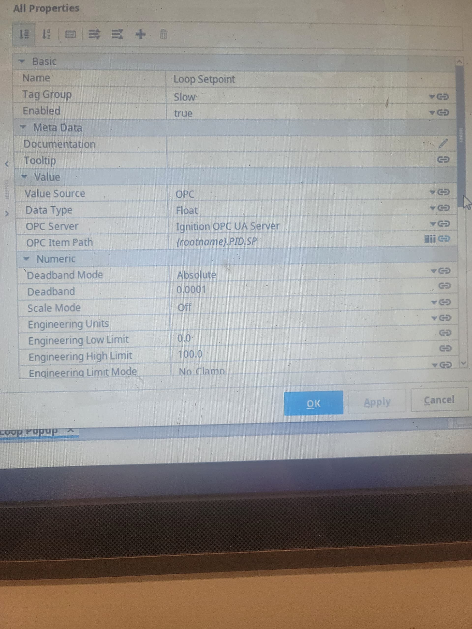

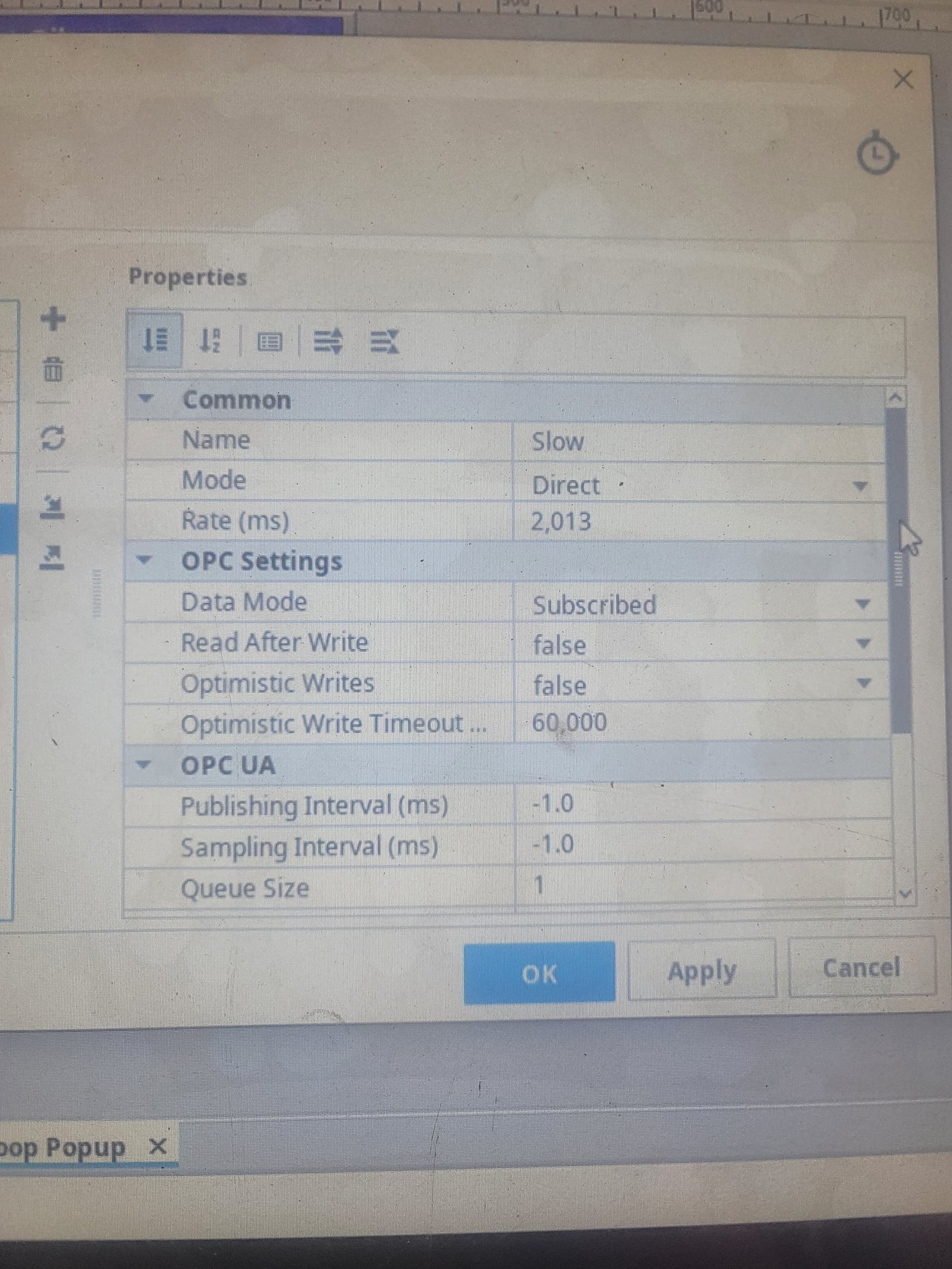

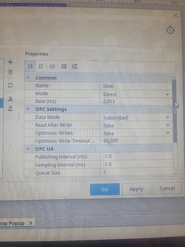

**Post date:** [June 30, 2025, 5:10pm UTC](https://forum.inductiveautomation.com/t/numeric-text-field-randomly-does-not-update/107764/12 "2025-06-30T17:10:49Z")
Value in PLC is 425, when template is displaying 375. Its on a slow poll group of 2000ms, so that might explain the behavior of it displaying the value entered in the keypad briefly in the numeric text entry before it reverts.
The tag is part of a UDT looking at a CLX PID tag.SP, so maybe the driver isnt efficient at querying that, although it has always worked elsewhere.

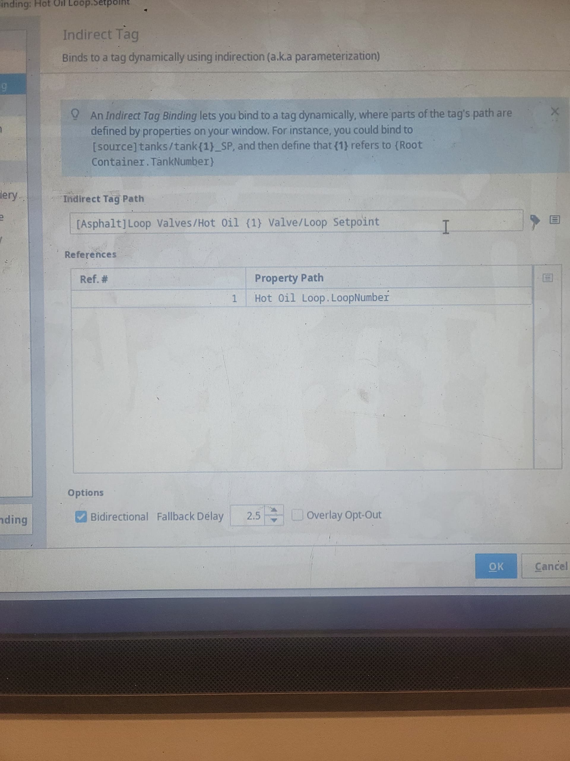

Attached is the template indirect value binding, the popup indirect binding, the UDT and the tag group. Only difference is I pass just the loop # to the template, whereas the full path to the popup, but its the same tag.

**Post date:** [June 30, 2025, 10:21pm UTC](https://forum.inductiveautomation.com/t/numeric-text-field-randomly-does-not-update/107764/13 "2025-06-30T22:21:36Z")
Ok, I was half expecting to see read after write on which can cause this, but not so much in this instance. I'm not sure in this case.
