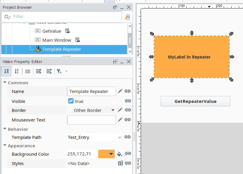

I'm encountering an issue when trying to access a component value within a Template Repeater in Ignition. To debug this, I have created a simple test screen based on the example code provided in the user manual. My goal is to display the text of a Label component inside the Template Repeater as a message when the button is clicked. However, I keep encountering errors when attempting to do this. Here's a screenshot of my test screen and the code I am using. Please note that I have ensured the component names match those in the example code. Can anyone provide assistance or guidance on how to resolve this issue?

error:
```auto
Traceback (most recent call last):
  File "<event:actionPerformed>", line 8, in <module>
AttributeError: 'com.inductiveautomation.factorypmi.application.com' object has no attribute 'getLoadedTemplates'
Ignition v8.1.21 (b2022092908)
Java: Azul Systems, Inc. 11.0.15
I also tried to change the getLoadedTemplates to getTemplateInstances , it does not work.
[Vision - Template Repeater - Ignition User Manual 8.1 - Ignition Documentation (inductiveautomation.com)](https://docs.inductiveautomation.com/display/DOC81/Vision+-+Template+Repeater)

The object you are displaying is named _Template Repeater_, but your icon is actually that of a template itself, not an actual template repeater. Are you using a template with a template repeater inside of it? If so, you will need to modify your script, so it gets the template repeater from inside the template itself .
**Example:**
```auto
from com.inductiveautomation.factorypmi.application.components import TemplateRepeater
visionTemplate = event.source.parent.getComponent('Template Repeater').getComponent(0)
for component in visionTemplate.getComponents():
	if isinstance(component, TemplateRepeater):
		#template repeater code here
		break
