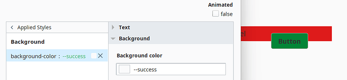

HI all. I’m trying to use a style class on a button. In particular, trying to use `--qual-2` for the background color. When I do, it goes transparent. This happens for anything with a -number on the end, e.g. `--neutral-10`. If I use any color that DOESN'T have a -number on the end, it works, e.g. `--success` or `--info` work fine. If I use direct styling, any color works fine. Am I doing something wrong? Thanks.
 ![Screenshot 2025-11-04 094326](https://us1.discourse-cdn.com/inductiveautomation/original/3X/e/7/e7074e315cefd38158820464cfd28e9963dbf809.png)
 ![Screenshot 2025-11-04 094441](https://us1.discourse-cdn.com/inductiveautomation/original/3X/8/e/8e2065f0152283cb4f0504ab9a2e9aea8e0de8f2.png)

Hey,
You have to surround your text with `var()`
If that doesn’t work, make sure the css variable `--qual-2` really exists.
**Author:** ![ingraham](https://avatars.discourse-cdn.com/v4/letter/i/3ab097/32.png) [@ingraham](https://forum.inductiveautomation.com/u/ingraham)\
**Post date:** [November 4, 2025, 4:03pm UTC](https://forum.inductiveautomation.com/t/odd-behavior-with-style-class-on-button/111933/3 "2025-11-04T16:03:12Z")
That worked! Thanks.
