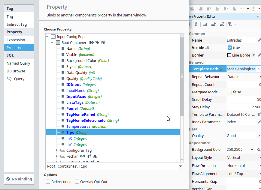

Great, but how can I select any property/parameter “data type” as of the template type?
**Author:** ![leonardo.godoi](https://sea1.discourse-cdn.com/inductiveautomation/user_avatar/forum.inductiveautomation.com/leonardo.godoi/32/27178_2.png) [@leonardo.godoi](https://forum.inductiveautomation.com/u/leonardo.godoi)\
**Post date:** [January 18, 2022, 7:05pm UTC](https://forum.inductiveautomation.com/t/one-master-window-to-receive-different-templates-and-control-those-child-parameters-tags/55108/5 "2022-01-18T19:05:40Z")
If i understood you correctly, you can bind the templatePath parameter of the template component on your window directly to the root container’s custom property you should’ve added.
The custom property name doesn’t matter, but it’s datatype is supposed to be a string containing the exact name of the template you want to be displayed on your screen, so if your root container’s property changes, it changes the tamplate being displayed.
I have mine setup like this:
 ![image](https://us1.discourse-cdn.com/inductiveautomation/original/3X/8/6/86eb366b58e12cb938c14a9758130a65b4b449d4.png)
