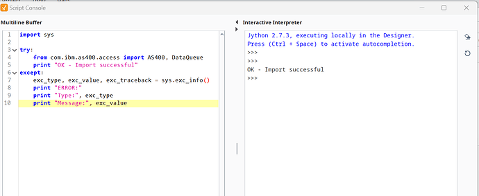

Hi all,
Not sure why
`from com.ibm.as400.access import AS400, DataQueue`
generated error
`Traceback (most recent call last):`
`File "", line 1, in `
`ImportError: No module named ibm`
in 8.3. But 8.1 is fine. Even though everything is working fine as is.
They both have jt400.jar installed correctly.
Thanks for inputs

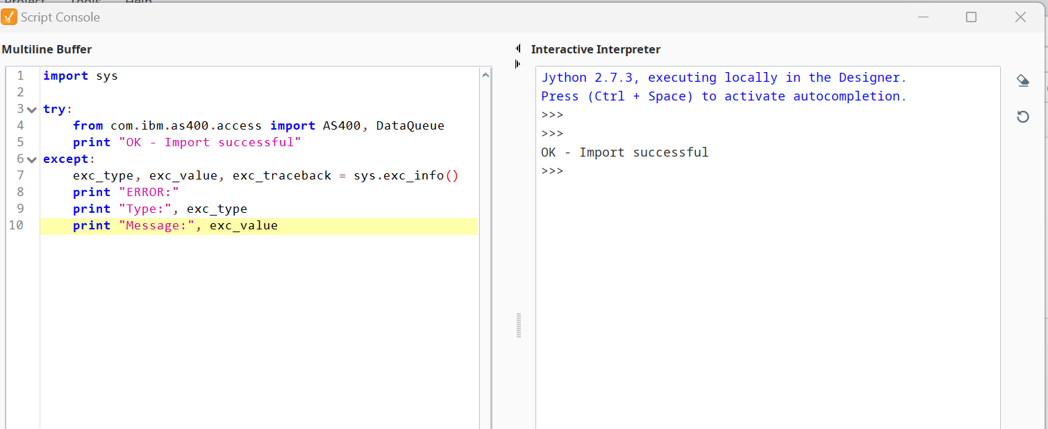

**Author:** ![uy\_huynh](https://avatars.discourse-cdn.com/v4/letter/u/54ee81/32.png) [@uy\_huynh](https://forum.inductiveautomation.com/u/uy_huynh)\
**Post date:** [February 13, 2026, 3:39am UTC](https://forum.inductiveautomation.com/t/one-of-the-codes-generated-error-in-8-3-but-everything-is-still-working-as-is/113948/5 "2026-02-13T03:39:11Z")
Hi Kevin,
I did restart the Gateway, and the existing event change script worked after the restart.
In Ignition 8.1, I imported the JAR file using the “Create JDBC Driver” option, so I’m not sure where that JAR was actually stored. I just checked, and the JAR is currently located in `core/common`, not in `core/gateway`.
For Ignition 8.3, I followed the same process. In addition, I manually copied the JAR file into both `core/common` and `core/gateway`.
It’s an event change script; it is working fine. The test script I tried in designer script console. Have a look at pics below.
Here is the 8.3
 ![image](https://us1.discourse-cdn.com/inductiveautomation/original/3X/d/0/d0ef2735350d8c226b335210e4c25ab03609cdc2.png)
Here is the 8.1
 ![image](https://us1.discourse-cdn.com/inductiveautomation/original/3X/3/f/3fd4e91c9f59c436968c1d39ea0043c0c1d6d00a.png)
**Post date:** [February 13, 2026, 3:41am UTC](https://forum.inductiveautomation.com/t/one-of-the-codes-generated-error-in-8-3-but-everything-is-still-working-as-is/113948/6 "2026-02-13T03:41:48Z")
You or somebody else probably also copied the JAR file to the right place on the Ignition 8.1 Gateway... installing/creating a JDBC Driver does not move the JAR into `lib/core/common` or `lib/core/gateway`.
**Post date:** [February 13, 2026, 3:44am UTC](https://forum.inductiveautomation.com/t/one-of-the-codes-generated-error-in-8-3-but-everything-is-still-working-as-is/113948/7 "2026-02-13T03:44:32Z")
Yep. I suspect that. It was long time ago so my memory could be wrong
