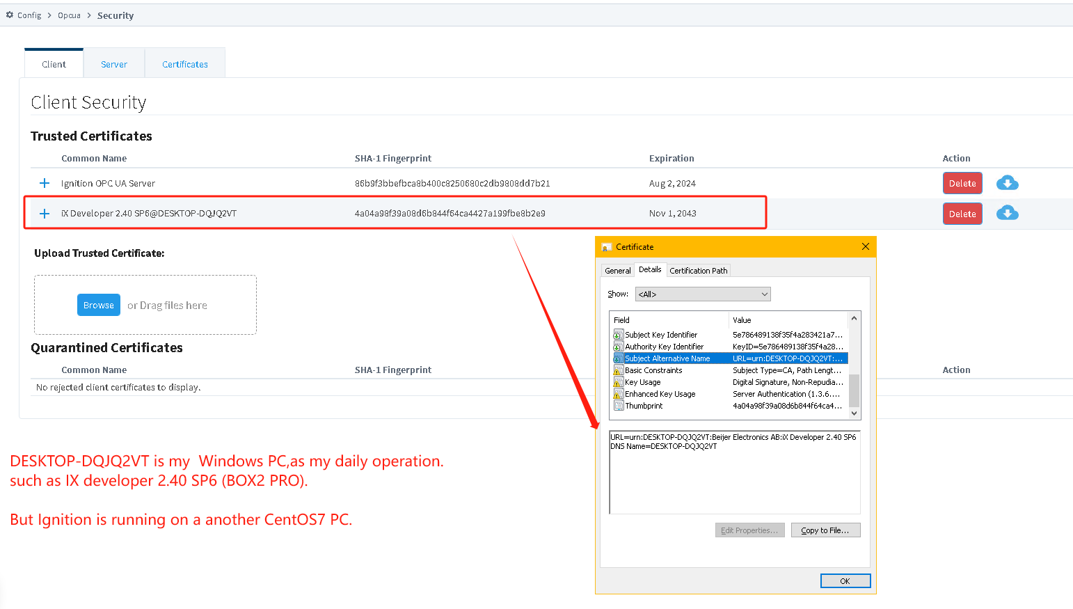

I have a BOX2 PRO communication module that supports OPC UA. When using UAexpert, I can connect and read data, but when creating an OPC connection using Ignition, I cannot connect. The error message indicates 'status=Bad\_CertificateUriInvalid, description=The URI specified in the ApplicationDescription does not match the URI in the Certificate'
image steps:
 ![image](https://us1.discourse-cdn.com/inductiveautomation/original/3X/e/c/ec2ad3195db240835c304f7bd9c393a9eaf4166e.png)
 ![image](https://us1.discourse-cdn.com/inductiveautomation/original/3X/6/e/6ed0201a09bd83c011b6db4d226519cbce94f940.png)
 ![image](https://us1.discourse-cdn.com/inductiveautomation/original/3X/4/d/4d453694ec5a5b3f0c38ce2045f94089ca42085b.png)

What version of Ignition are you using?
edit: nevermind, I see it's 8.1.7 in the screenshot.
It's possible the problem is exactly what the error says: the URI in the certificate does not match the one returned by the GetEndpoints service. You will need to get a Wireshark capture to verify.
