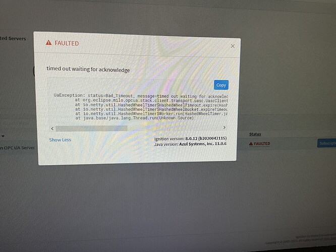

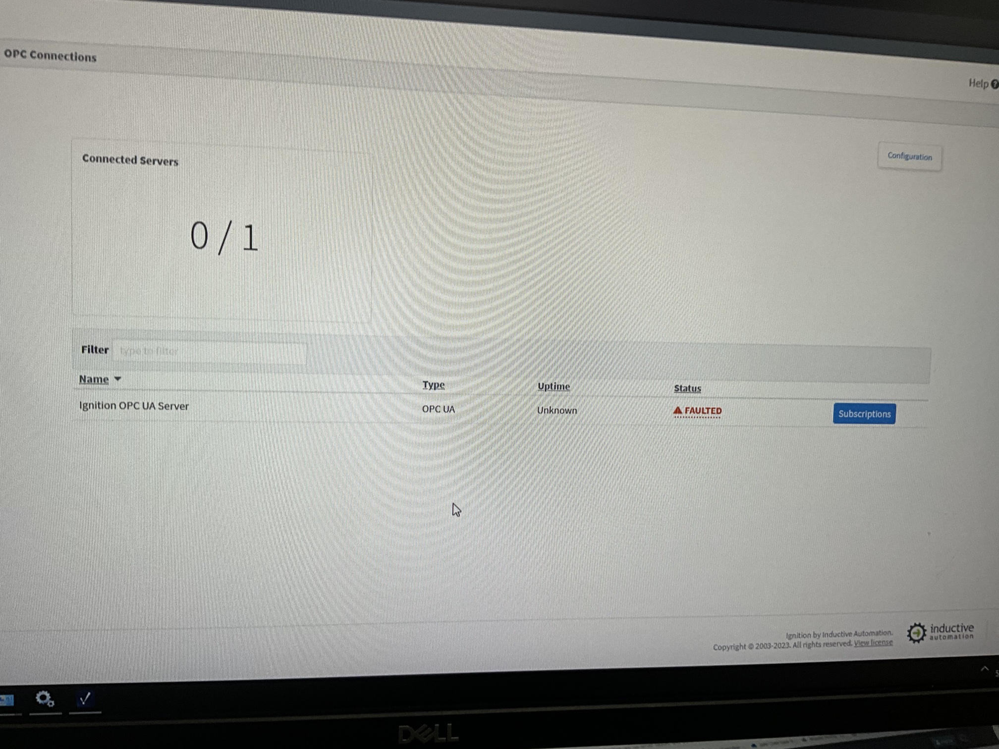

I have a problem with one of the servers that we used, on section OPC connection mark a fault and do not have connection, its supposed to be connected on a server created with SQL, the server store the data provide by multiple PLC AB
Attach are the fotos of the error, i will really appreciate the help at the moment i,m completely blocked

> [@Victor\_Diaz](#):
What does this mean? SQL and OPC/UA are different technologies. Also, your photo show what is normally Ignition's own predefined self-connection that is faulted. This would be a separate problem from a broken database connection.
Please explain more about how you got into this situation (and if this is new, why you are using an ancient and unsupported Ignition version).
{ Consider using screen captures instead of actual photos--the moiré patterns are quite distracting. Also, you can use the "Copy" button in the upper right corner of an error report to place the text in you clipboard. Which you can then paste here, with the "Preformatted Text" style applied. }
