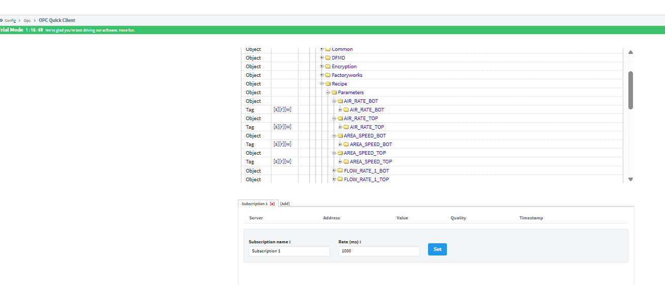

 ![image](https://us1.discourse-cdn.com/inductiveautomation/original/3X/6/f/6f38ae94d5806c9460c7cf96cf12caa16f55ab18.png)
When my dataType is set to “Float” in my xml data

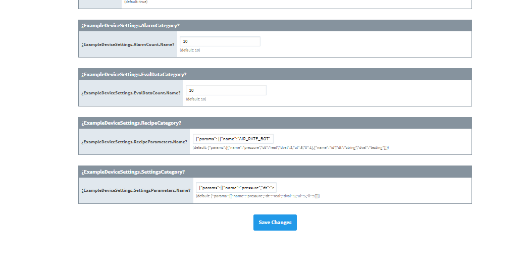

 ![image](https://us1.discourse-cdn.com/inductiveautomation/original/3X/6/2/627fdec74036a4350bb7df12264b9cdb34d8e7b3.png)
When my dataType is set to “real” in my xml

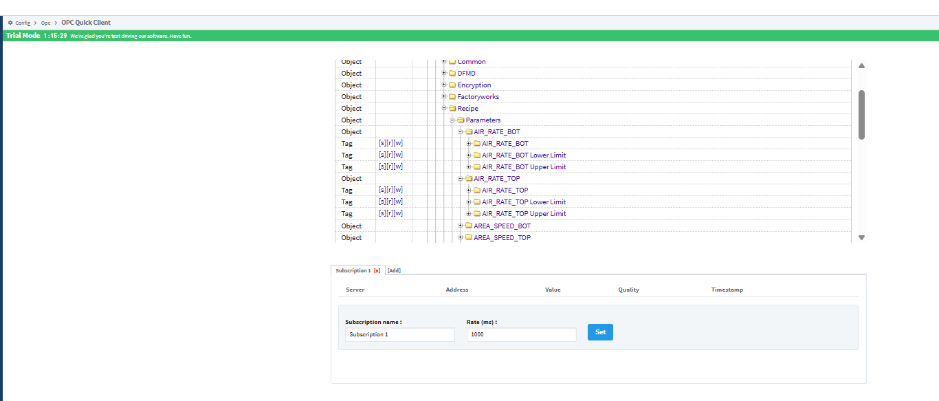

 ![image](https://us1.discourse-cdn.com/inductiveautomation/original/3X/c/e/ced53d117a75ff95d6fe89a2a4cf3236763ee47a.png)
