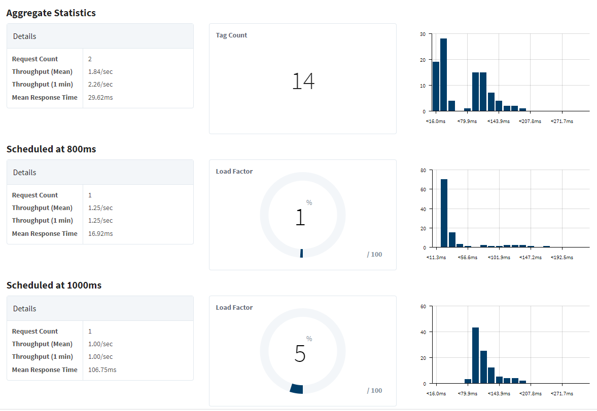

**Author:** ![Tyler\_Earl](https://avatars.discourse-cdn.com/v4/letter/t/a88e4f/32.png) [@Tyler\_Earl](https://forum.inductiveautomation.com/u/Tyler_Earl)\
**Post date:** [October 21, 2022, 7:08pm UTC](https://forum.inductiveautomation.com/t/opc-disconnects-and-long-read-write-periods/65545/6 "2022-10-21T19:08:05Z")
> [@pturmel](#):
> Look at the device status pages for each of your PLCs. Snapshot for us. In particular, what are the typical PLC response times? How many requests are in each subscription group? Do the status pages show any overload?
This is for one of the omron plcs, I can post the other 3 if required, but all of the statistics were virtually identical.
 ![image](https://us1.discourse-cdn.com/inductiveautomation/original/3X/f/d/fdf0cdd4ece07c4ea52363c952a38d6492dabda1.png)
Here are the stats for one of our siemens plcs, this is the most problematic one. Again, i can upload the other ones if we think it may be helpful.

**Post date:** [October 21, 2022, 7:14pm UTC](https://forum.inductiveautomation.com/t/opc-disconnects-and-long-read-write-periods/65545/10 "2022-10-21T19:14:09Z")
Those are perfectly normal response times. Your server is extremely lightly loaded. I suspect you are suffering from algorithmic problems. (Like writing tags from two directions.)
(Well, the Omron response times are somewhat long, but I'm not familiar with that model. It's kind of wimpy, if I recall correctly.)

Yes, its one of their lightweight models. Its perfectly capable for the machine they are running as its not doing much. At this point, if we wasn't also having problems on our Siemans machines then I might tease the idea of the PLC being at fault. I would also like to remind you that these read/writes weren't always this slow either. Something happened when we removed those 16 plcs from ignition. Once those were removed, and scripts/queries were rewritten then the problems set in.
