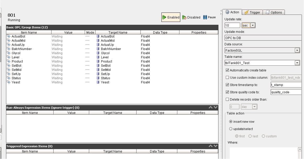

I have setup a transaction group with OPC items to a siemens PLC. the values for the items say waiting. i can see values for the addresses when I view them in sqltags. attached is a log with trace turned on for the siemens driver.

Are the values coming through in the database? Is the group triggered?

I would check Status\>OPC to see if the items are properly subscribed and have values there. I suspect it could be a problem with the addressing in some way. The “waiting” would indicate that the items simply aren’t getting any type of value update.

The database table is being filled with NULLs.
I do not have a trigger set.
The problem was the addresses. I thought they were the same as the address used in my SQLTags, but come to find out they did not match the addresses used in SQLTags.
