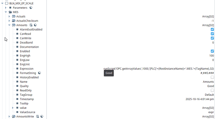

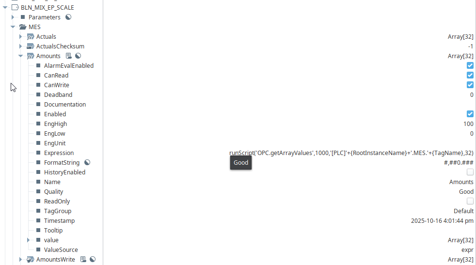

A solution I have implemented is a polled opc read, which converts the data into a Ignition Float Array tag. When I want to write back, I have a Float Array tag with a change script.
Here is the function I use, works pretty well, you just need to remember to set the correct size.
```python
def getArrayValues(opcPath,size):
    return [i.value for i in system.opc.readValues('Ignition OPC UA Server', ['{}[{}]'.format(opcPath,i) for i in range(0,size)])]
def setArrayValues(opcPath,values,size):
    itemPaths= ['{}[{}]'.format(opcPath,i) for i in range(0,size)]
    system.opc.writeValues('Ignition OPC UA Server', itemPaths, [round(x,2) for x in values])
Hope this helps
 ![image](https://us1.discourse-cdn.com/inductiveautomation/original/3X/3/7/3713b0acd7fd3183c4437d1575a0f858a62d498b.png)
