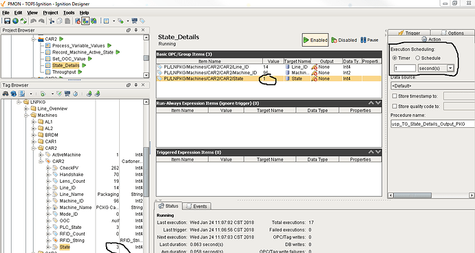

Hi
We are encountering that the OPC Tag in Transaction Group does not update.
In the tag browser state = 3 while in the transaction group tag State = 1
It has the same location and the execution scheduling timer is 1 seconds

**Post date:** [January 24, 2018, 12:43pm UTC](https://forum.inductiveautomation.com/t/opc-tag-in-transaction-does-not-update-even-though-the-tag-browser-changing/16709/2 "2018-01-24T12:43:03Z")
Those values update when the transaction triggers. They aren’t “Live”.

**Author:** ![chi](https://avatars.discourse-cdn.com/v4/letter/c/0ea827/32.png) [@chi](https://forum.inductiveautomation.com/u/chi)\
**Post date:** [January 26, 2018, 3:59pm UTC](https://forum.inductiveautomation.com/t/opc-tag-in-transaction-does-not-update-even-though-the-tag-browser-changing/16709/7 "2018-01-26T15:59:05Z")
You are mixing up trigger and scheduling. Your Screenshot shows a 1 second execution timer. In the statistics at the bottom, you see that the last _trigger_ happened at 11:06:56, the last _execution_ at 11:07:02.
As pturmel wrote, the values update with the trigger, not with every execution. So, check your trigger settings.
**Author:** ![trishhiyah](https://avatars.discourse-cdn.com/v4/letter/t/9fc29f/32.png) [@trishhiyah](https://forum.inductiveautomation.com/u/trishhiyah)\
**Post date:** [April 24, 2018, 1:53am UTC](https://forum.inductiveautomation.com/t/opc-tag-in-transaction-does-not-update-even-though-the-tag-browser-changing/16709/8 "2018-04-24T01:53:15Z")
My trigger settings is only execute when values have changed which is the State tag. But my problem is the State Tag is not updating in transaction group even though the tag of opc has changed.

**Author:** ![dmusser01](https://avatars.discourse-cdn.com/v4/letter/d/bb73d2/32.png) [@dmusser01](https://forum.inductiveautomation.com/u/dmusser01)\
**Post date:** [May 31, 2018, 12:36pm UTC](https://forum.inductiveautomation.com/t/opc-tag-in-transaction-does-not-update-even-though-the-tag-browser-changing/16709/9 "2018-05-31T12:36:09Z")
What was the fix? Have same problem here where the value in the group items are not changing (except where I disable and enable then save), but I can see the value changing in the OPC tag browser.
**Post date:** [May 31, 2018, 3:29pm UTC](https://forum.inductiveautomation.com/t/opc-tag-in-transaction-does-not-update-even-though-the-tag-browser-changing/16709/10 "2018-05-31T15:29:20Z")
There wasn’t anything to fix. The values aren’t supposed to update in that display all the time. They show the values from the last _trigger_.
