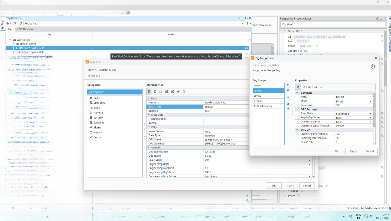

Hi Everyone,
 ![image_1000ms](https://us1.discourse-cdn.com/inductiveautomation/original/3X/8/a/8a3c2fa6b7a8cf87fe3765bce26fe66285eef5a4.jpeg)
 ![image_800ms](https://us1.discourse-cdn.com/inductiveautomation/original/3X/e/6/e6d4fe33682cd80da29fd8a809de4e3b45848cfd.jpeg)
I am facing an issue with OPC tag scan rates in Ignition.
**Issue Description:**
When I configure the scan rate as **800ms** , the tag quality shows:
_Bad\_ConfigurationError: There is a problem with the configuration that affects the usefulness of the value._
However, when I change the scan rate slightly to **1000ms** , the same tag starts working normally without any issues.

**Post date:** [April 1, 2026, 12:10pm UTC](https://forum.inductiveautomation.com/t/opc-tag-scan-rate-800ms-causing-bad-configurationerror-but-1000ms-works/114830/2 "2026-04-01T12:10:02Z")
It's more likely that by putting it into the 800ms tag group, you've joined it up with other tags already in that group, and the tag has ended up in a request for a combination of tags that is failing because it includes an invalid (non-existent) address or something.
Assuming this is the legacy Siemens driver, Bad\_ConfigurationError is typically only used for address syntax errors or when the read result contains an error code.

Thanks for the guidance.
You were right — the issue was caused by an invalid tag within the same 800 ms tag group. Since the tags are read in a batch, the presence of that incorrect/non-existent address caused the entire request to fail, resulting in the Bad\_ConfigurationError.
After identifying and correcting/removing the problematic tag, the remaining tags are now working as expected, even at the original scan rate.

**Root Cause:** An invalid Siemens PLC tag address was configured in Ignition. The OPC Item Path was pointing beyond the actual PLC Data Block size (e.g., DB size is 100 bytes, but the configured address was greater than 100).
**Solution:** Verify that all OPC Item Paths are within the valid PLC Data Block range. After correcting the invalid tag address, the issue was resolved.
