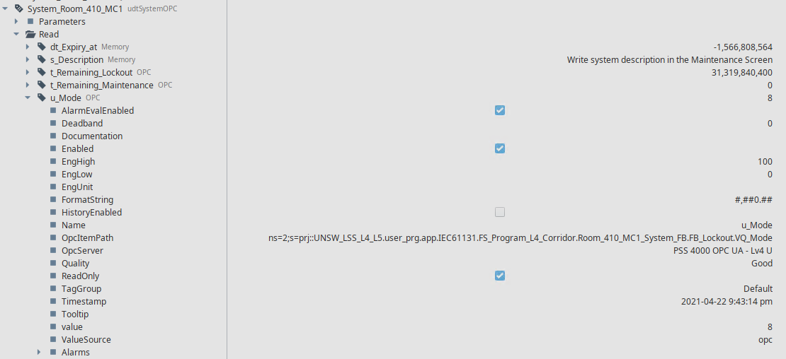

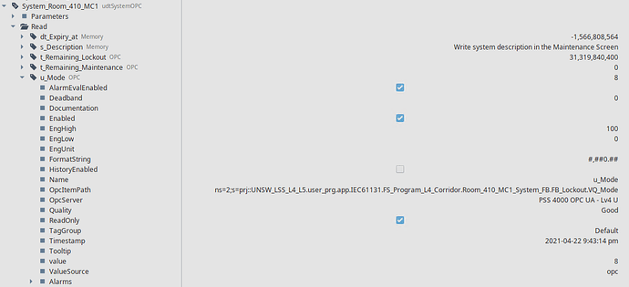

We already tried multiple troubleshooting procedures here, the observed behaviour when the tags freezes are:
a. The tag keeps its quality as “Good” and the time stamp from the last change that was captured by the system.

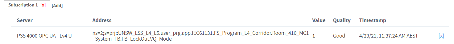

b. Using the OPC quick client we see the variable with the right value.
c. If I change anything in the tag, or even copy and paste it, it starts to respond and works well for a few days.
Frozen tag
 ![image](https://us1.discourse-cdn.com/inductiveautomation/original/3X/3/a/3a429a545a92ca9273d908e4a9c21f99a55baf75.png)
OPC quick client
 ![image](https://us1.discourse-cdn.com/inductiveautomation/original/3X/b/0/b0aa91c47e7095ecabaf9d8cf8f37db0d04f8165.png)

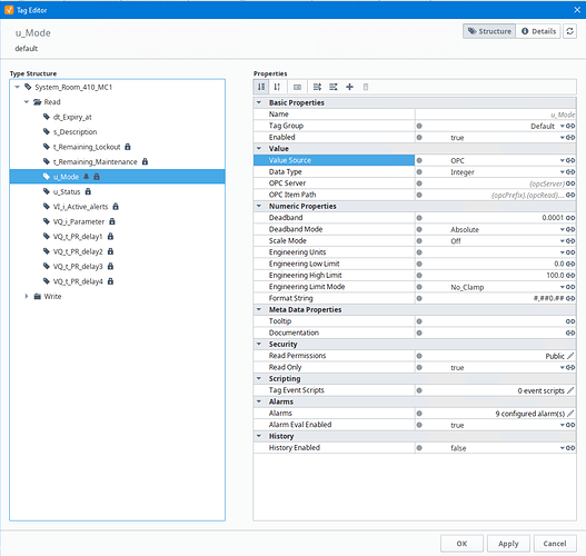

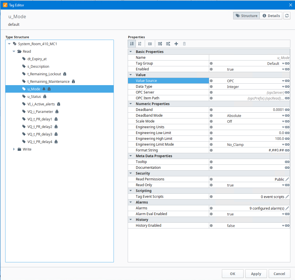

Tag configuration:
 ![image](https://us1.discourse-cdn.com/inductiveautomation/original/3X/3/b/3b5c6556772b988416fbc39bb435699d4b973f97.png)
