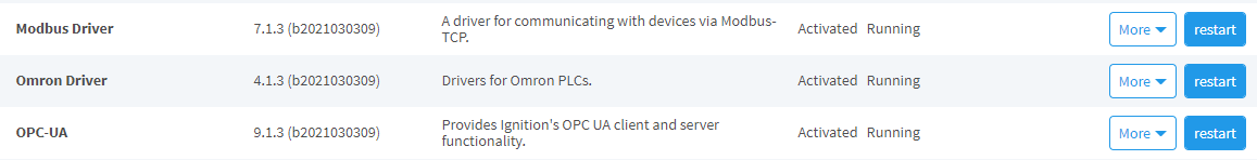

Hi
We have Ignition Edge installed on a moxa switch which is connected to a Modbus TCP device. I created a device under config\>Opcua\>Devices. Everything is working fine. Every now and then if I power cycle the whole panel (Edge device + Modbus device), my tags change to “Bad\_NotConnected”. If I then go to config\>Opcua\>Devices I see the device is connected. If I then go to config\>opc\>OPC Quick client, I can drill down to the device and r/w any value without any issues. The problem is that all my tags stay “Bad\_NotConnected” until I restart the edge device or re-enable the device under config\>Opcua\>Devices (sometimes) or restart the opc ua module.
It is as if the GW eventually makes connection to the Modbus device but the tags don’t. Any Idea what could cause/solve this issue?
I did set Max Retry Count = 10 (config\>Opcua\>Devices\>MyMBDevice\>edit) but that didn’t seem to help.

What version of ignition?
**Author:** ![hventer23](https://avatars.discourse-cdn.com/v4/letter/h/bbce88/32.png) [@hventer23](https://forum.inductiveautomation.com/u/hventer23)\
**Post date:** [April 20, 2021, 8:20am UTC](https://forum.inductiveautomation.com/t/opc-tags-stay-unhealthy-even-after-device-is-reconnected/45741/4 "2021-04-20T08:20:47Z")
Ignition Edge Version 8.1.3
And module drivers are shown below:
 ![image](https://us1.discourse-cdn.com/inductiveautomation/original/3X/8/4/84c76bc1c3149d10573743414c2673eb1427bf5f.png)
**Post date:** [April 20, 2021, 11:59am UTC](https://forum.inductiveautomation.com/t/opc-tags-stay-unhealthy-even-after-device-is-reconnected/45741/5 "2021-04-20T11:59:55Z")
Hmm. 8.1.5 includes a fix for something that sounds a bit like this…

I went and took a look at the changelog the only thing I could see maybe relating to the issue was the following:
## Connectivity
**2044: TCP Driver can saturate shared execution engine if many devices are defined and unavailable**
To prevent saturation of the shared execution engine thread pool, the TCP Driver now uses the opc-ua-executor thread pool to connect.
But since 8.1.4 is the current stable build and since this system is now up and running, would it be best if I wait for 8.1.5 stable build?

No, we missed a couple change log entries.
The one I'm thinking of will read something like this:
> Fixed a bug that caused tags to get stuck with Bad\_NotConnected or Uncertain\_InitialValue quality on startup or reconnect.
**Author:** ![bmusson](https://sea1.discourse-cdn.com/inductiveautomation/user_avatar/forum.inductiveautomation.com/bmusson/32/87530_2.png) [@bmusson](https://forum.inductiveautomation.com/u/bmusson)\
**Post date:** [April 21, 2021, 7:57pm UTC](https://forum.inductiveautomation.com/t/opc-tags-stay-unhealthy-even-after-device-is-reconnected/45741/10 "2021-04-21T19:57:49Z")
This one?
> Nightly Changelog: 8.1.5-b20210413 - addendum
> **2081: OPC tags get stuck with Bad\_NotConnected or Uncertain\_InitialValue on startup or reconnect**
**Post date:** [April 21, 2021, 7:59pm UTC](https://forum.inductiveautomation.com/t/opc-tags-stay-unhealthy-even-after-device-is-reconnected/45741/11 "2021-04-21T19:59:58Z")
Yeah that one. It wasn’t in there this morning 🙂
**Post date:** [April 22, 2021, 5:36am UTC](https://forum.inductiveautomation.com/t/opc-tags-stay-unhealthy-even-after-device-is-reconnected/45741/12 "2021-04-22T05:36:03Z")
Yes that definitely got added or I missed it multiple times. Thank you for clearing this up for me guys.
