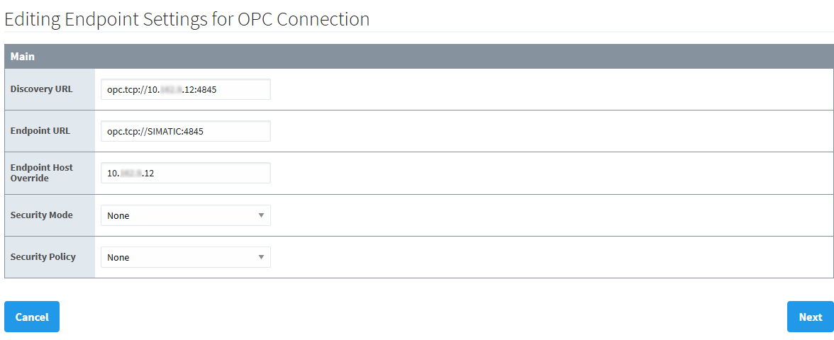

Hello everyone,
I’ve tried to connect to a machine’s PLC with Ignition via OPC UA.
The PLC allows anonymous connection thus i do not have a user or password .
I already connected to the PLC using UA Expert without any problems.
When i try to connect via Ignition from the same server i get a FAULTED connection with this additional text:
`java.lang.NullPointerException: Cannot invoke "String.hashCode()" because "<local1>" is null`
`	at org.eclipse.milo.opcua.stack.core.transport.TransportProfile.fromUri(TransportProfile.java:26)`
`	at org.eclipse.milo.opcua.stack.client.UaStackClient.create(UaStackClient.java:389)`
`	at org.eclipse.milo.opcua.sdk.client.OpcUaClient.create(OpcUaClient.java:158)`
`	at com.inductiveautomation.ignition.gateway.opcua.client.ManagedClientKt.createClient(ManagedClient.kt:220)`
`	at com.inductiveautomation.ignition.gateway.opcua.client.ManagedClientKt.initialize(ManagedClient.kt:141)`
`	at com.inductiveautomation.ignition.gateway.opcua.client.ManagedClientKt.access$initialize(ManagedClient.kt:1)`
`	at com.inductiveautomation.ignition.gateway.opcua.client.ManagedClientKt$initialize$1.invokeSuspend(ManagedClient.kt)`
`	at kotlin.coroutines.jvm.internal.BaseContinuationImpl.resumeWith(ContinuationImpl.kt:33)`
`	at kotlinx.coroutines.DispatchedTask.run(DispatchedTask.kt:106)`
`	at java.base/java.util.concurrent.ThreadPoolExecutor.runWorker(Unknown Source)`
`	at java.base/java.util.concurrent.ThreadPoolExecutor$Worker.run(Unknown Source)`
`	at java.base/java.lang.Thread.run(Unknown Source)`
`8.1.36 (b2024010211)`
`Azul Systems, Inc. 17.0.8`

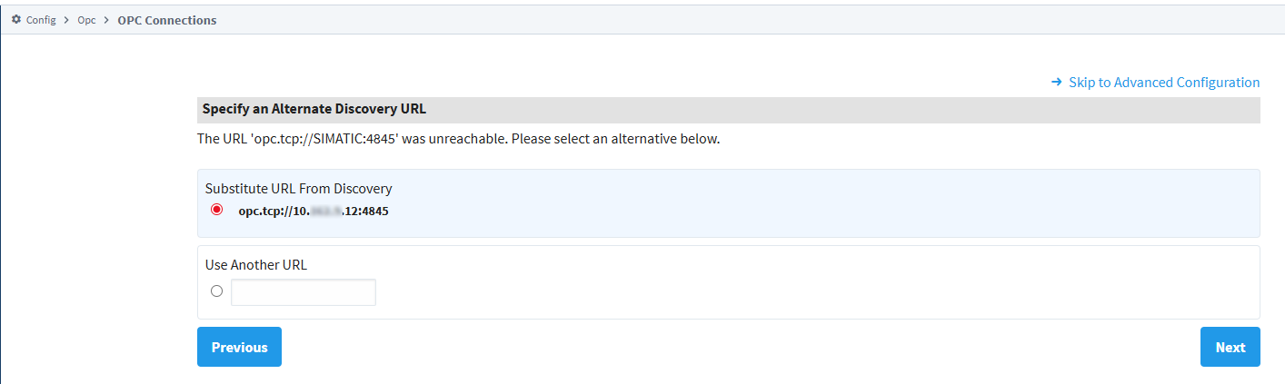

In the Logs i have the following messages
`2025-11-07 11:36:56:361 webserver-5106140`
`Error looking up endpoint`
`java.util.concurrent.ExecutionException: java.net.UnknownHostException: No such host is known (SIMATIC)`

`Caused by: java.net.UnknownHostException: No such host is known (SIMATIC)`

Is this happening during the discovery wizard? What is the exactly discovery / endpoint URL you are entering?
**Author:** ![GeraldB](https://sea1.discourse-cdn.com/inductiveautomation/user_avatar/forum.inductiveautomation.com/geraldb/32/36210_2.png) [@GeraldB](https://forum.inductiveautomation.com/u/GeraldB)\
**Post date:** [November 7, 2025, 11:34am UTC](https://forum.inductiveautomation.com/t/opc-ua-connection-error-nullpointerexception/112033/3 "2025-11-07T11:34:39Z")
During the discovery wizard everything works as usual. The wizard shows the server and asks for alternative discovery URL, endpoint and hostname override, always with prefilled IP address.
i tried opc.tcp://10.XXX.YYY.12:4845 and opc.tcp://10.XXX.YYY.12:4845/discovery. Both got the same result.
 ![image](https://us1.discourse-cdn.com/inductiveautomation/original/3X/f/0/f04a17378d15bc3d5820e910d8f439ac2c6c3a73.png)
**Post date:** [November 7, 2025, 12:02pm UTC](https://forum.inductiveautomation.com/t/opc-ua-connection-error-nullpointerexception/112033/4 "2025-11-07T12:02:49Z")
Click that "skip to advanced configuration" link at the top right and show me what you see there.
**Post date:** [November 7, 2025, 12:21pm UTC](https://forum.inductiveautomation.com/t/opc-ua-connection-error-nullpointerexception/112033/5 "2025-11-07T12:21:37Z")
![image](https://us1.discourse-cdn.com/inductiveautomation/original/3X/9/8/9858a18b4a76f21e55bd816cae74ce803b692fef.png)
Both blurred IPs are the same
**Post date:** [November 7, 2025, 12:24pm UTC](https://forum.inductiveautomation.com/t/opc-ua-connection-error-nullpointerexception/112033/6 "2025-11-07T12:24:39Z")
This all looks right, there must be a field coming back in the EndpointDescription that is null and probably shouldn't be, and we're not looking for it or expecting it, and just passing that value on into the SDK.
