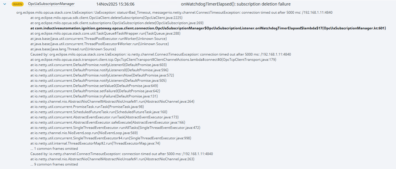

Hi all,
Using updating to 8.3.1: after a device has lost it connection due to power cycles, it does not reconnect. Anyone else experienced this ?
Very little information to share as we where dealing with it late Friday evening and didn’t copy that much. But need to get it going again Monday. Thanks
onWatchdogTimerElapsed(): subscription deletion failure
**Post date:** [November 15, 2025, 11:51am UTC](https://forum.inductiveautomation.com/t/opc-ua-dont-reconnect-after-communication-lost/112204/2 "2025-11-15T11:51:40Z")
We’ll need logs and a Wireshark capture to get anywhere. This isn’t enough information to act on.

We clearly need to collect more data, but here is a bit more…
 ![image](https://us1.discourse-cdn.com/inductiveautomation/original/3X/5/3/534669b67cd396dd6beaa27a6b019ea998446fcb.png)
 ![image](https://us1.discourse-cdn.com/inductiveautomation/original/3X/5/3/539c44be677a2f6183e9cec9c71dbfacd136068d.png)
**Post date:** [November 15, 2025, 2:34pm UTC](https://forum.inductiveautomation.com/t/opc-ua-dont-reconnect-after-communication-lost/112204/4 "2025-11-15T14:34:45Z")
All that we’re really seeing here is that you’ve lost your connection to the server and the reconnection attempt hasn’t succeeded yet because opening the TCP connection times out.

I can add that uaExpert connected to the same server w/o any hickups. Wel will dig into it first thing tomorrow.
